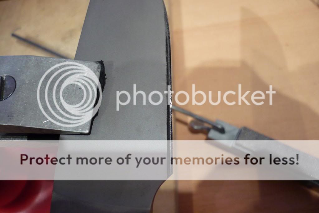

The use of a sharpie or marker on the edge and looking at how the ink is removed by gradually re-profiling the edge can be seen here from a pic I did for someone wanting a tutorial on using a Lansky system ...

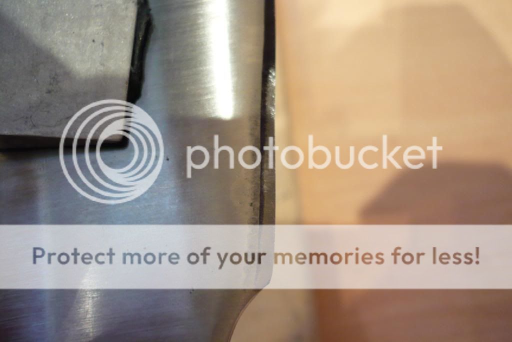

This was my first Busse, a Skinny Ash, I wanted to thin the edge down to a 40 degree bevel. The ink from the marker in the pic below spilled onto the blade flat but you can see from the first few strokes where the shoulder of the edge is and how this is being worked on by the stone.
This pic shows the edge in it's final phase, the ink has nearly all been removed towards the pinnacle. Now is the time you would move to finer stones to polish the edge. When the angle of the stone and edge are exact a few strokes should remove all the ink on the edge. This lets you know it is time to polish the edge and refine it for razor sharpness.
