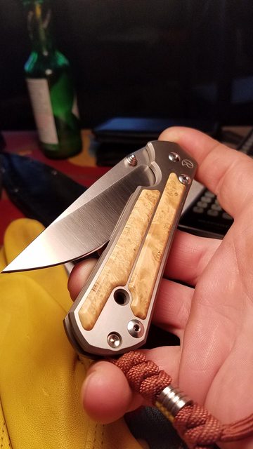

so , i don't really need the sharpm... just the stones spyderco sells ?
my 21 will be back from spa and i've never sharpened it. others , yes
i use dia-fold and do it freehand but w/ this crk i'd like to be able to maintain it and never change the factory bevels.
