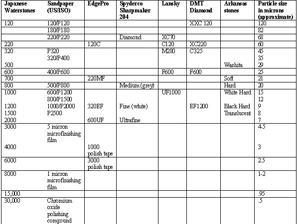

Where are those numbers from? The only reason I ask is I saved this picture from a previous thread that shows the F stones to be 9 microns and UF to be 7:
I have no idea where the picture's numbers come from, which is also why I ask.
That chart is not that accurate.
From Sal himself the ceramics are.....
Medium = 15 microns
Fine = 6 microns
Ultra Fine = 3 micron
we have lots of guys that get really sharp edges but when it comes to accurate technical info it's hard to beat knifenut1013 . a good point he mentioned is that trying to shortcut grit size when getting on down to 3 micron or so will make the extreme edge very sharp but some of the bevel above the edge may retain scratches from coarser mediums. in effect the final edge may be very sharp but the entire bevel or bevels will not be as polished as possible which means that the coefficient of friction will be greater for the two of = sharpness edges that has not received the max. polish on metal above the very edge. if i have interpretated knifenuts comments i'm sure he will correct me.
