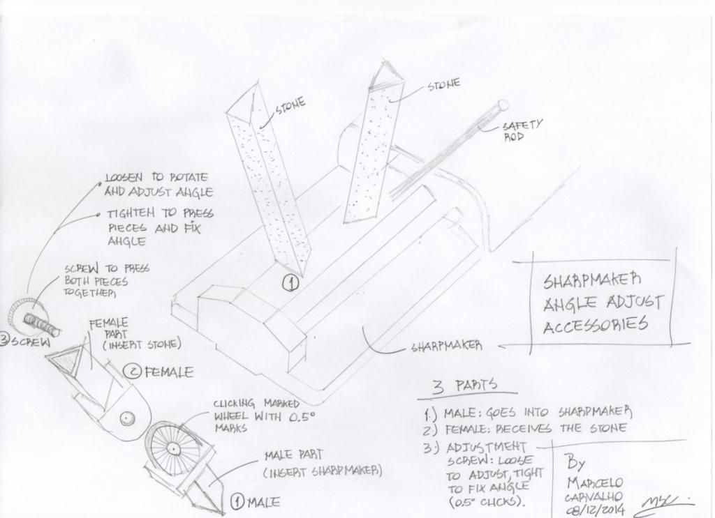

Hello Everyone,
It's my first time writing on this forum, but I am a long time "watcher".
I always loved Spyderco knifes and the Sharpmaker: great system, easy to use, small package. The only thing that bugs me about the SM is the only two options for sharpening angles. For most knives, I usually go with a 40 degrees microbevel and works nice, but sometimes, I feel like the steel can take an even sicker edge (like ZDP). I was wondering how to do this with SM and had an idea... It is very simple and if I could think about it, probably the guys at Spyderco did it many years ago, but I felt like I should post it here anyway.
So it consists of a simple small add-on to the existing sharpmaker: a small plastic piece, male in one end (goes into the sharpmaker) and female in the other end (to receive the stone) and, in between, a clicking wheel with 0.5 degrees marks that would allow rotation when the pivot is loose and lock in when it is tight.
What do you guys think?
Interesting idea. I have a simpler workaround I use when I want to change the angle. I tape a pencil, marker or other round object to the bottom of the sharpmaker right in the middle. Then I just "see saw" the sharpmaker with each stroke. Works fine and you can get any angle u want depending on the size of the object you use. I like your idea as a more refined and permanent solution though!

The question has been brought up several times with some, like yours, very innovative ideas. We'll see how the disucussion goes? The complexity / simplicity concept, the higher cost in tooling and building / sufficient sales to to justify investment, as well as other hurdles must be weighed.

One thing that may be a "pro" on this possibility is that parts would be small and molded, while all the original Sharpmaker (still great) is kept unchanged. Maybe it could be an optional additional product, or included in the SM package. I pretty sure you guys know what's the best alternative!
Other thing that might be cool is that there would very little learning curve: user decides how many clicks (degrees or half degrees) per side they want to add/decrease on the 30 our 40 degrees original setup. Even assimetric sharpening would be very viable with this little piece (chisel grind for instance).

Excellent idea, and great drafting also! Different angles can be achieved by placing something under one end of the base plus using an angle cube, but I could see the risk, for lack of a better word, involved with producing an item like this.

I have another idea. Make two fixed plastic inserts that that each change the angle by 2 degrees. So the 40 degree slots could be converted to 36 and the 30 degree slots to 26. But don't forget, they could be reversed to make the angles wider too. So you would now have 26, 30, 34 degree, and 36, 40 & 44 degree options. And....if the inserts are done like the current holes you could even twist the rods 1/6th turn and pretty much split the difference, so you could sharpen at most any angle between 26 and 44 at 2 degree increments.

They could make a base that would accept dovetailed blocks with different angles on them. If you wanted to use different angles, just slide one block out, and slide another one in. Since all the pressure on a Sharpmaker is vertical, I don't think you would have to worry about the angle blocks sliding out on their own. It wouldn't be infinitely adjustable like the OP's idea, but it would still make the system more versatile than the current version, and it wouldn't be that much different from what we already have.

I'm less certain of how easy it would be to make something like that which would be adjustable but not slip/move/flex while you were sharpening. Think perhaps some variation on Surfingringo's idea of several sets of inserts might work better in practice.
