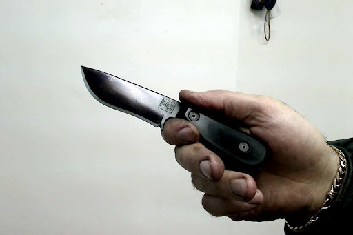

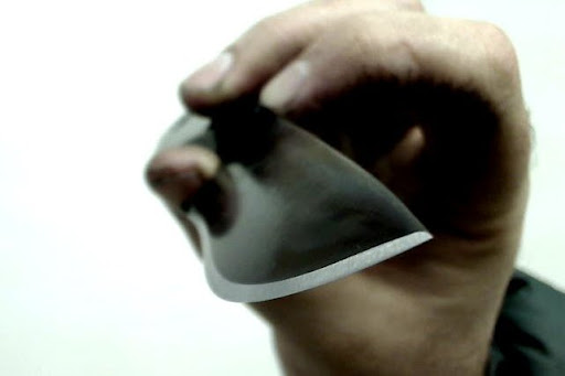

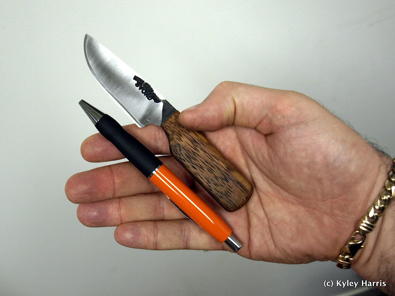

OKay.. twist my ARM! lol..

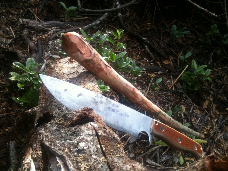

I have a website, but i tend not to market on the forums. my youtube channel has all my stuff on it.. I tend to convex every blade I buy nearly.. lol..
plus I make a knife called the ckc Hiker and ckc belt, which I did about 330 over the last year or so.. Shows that a crappy 1x30 can do the business (if a little slower)
my new design is called the forrester.
I love my NMSFNO, and SAR8, but this is a lightweight 13.7OZ blade in similar size package.. 5/32" thick O1, soon to be D2

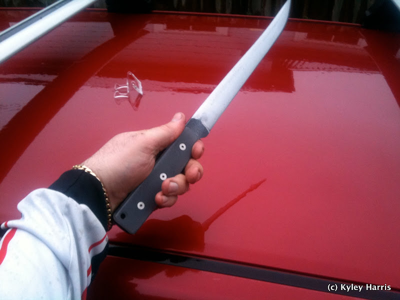

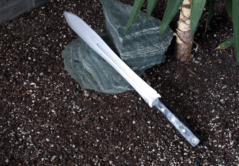

D2 Test Cutting sword. 24" blade

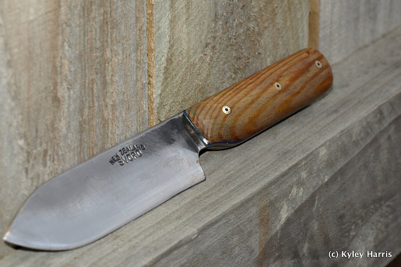

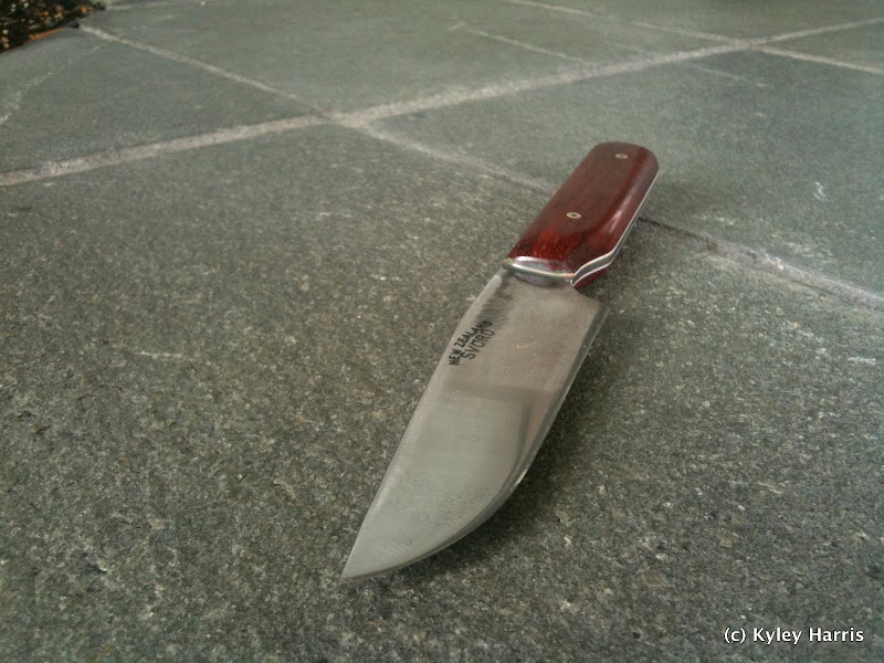

2 of my designs I had SVORD NZ cut and treat the blades for me in bulk.
hence the logo
