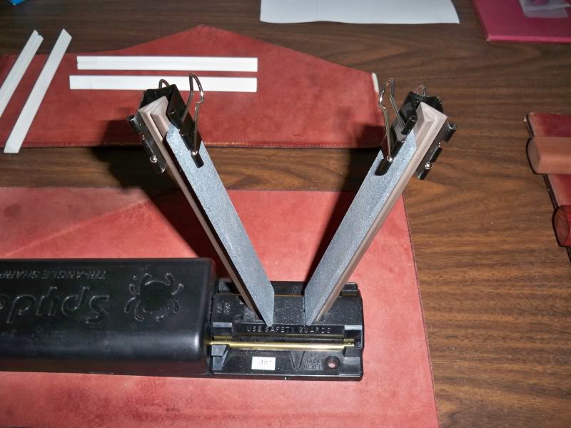

If you want BK-2 to become shaving sharp with Sharpmaker you need to do it gradually. First you need something like this:
I use Congress Tools Moldmaster stones,120, 240, and 400 grit. Angle 30 degrees. After that brown stones,white ones,and finally super fine ones. Even without strop you will have
shaving sharp blade.
30 degrees will not hold the edge as 40 degrees ,so it's up to you on angle. But even with 40 degrees ,knife will be shaving sharp and cut throug paper.
For me, the key thing is to start very low, with 120 grid,because if you start with brown stones on Sharpmaker you will need to spend eternity to profile correct edge.
Anyway this is my experience with that,maybe someone have different opinion.
Is that sandpaper or a stone attached to the rods woody Allen? Now that I think about it I read about attaching sandpaper to the stones at first to reprofile. Guess I will keep at it with the gray stones.
