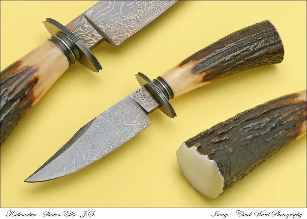

I shot Shawn's knife yesterday and he asked me to post it. Beautiful knife.
Damascus back draft pattern made of 15n20 & 1084 and it’s been hot blued.
The guard, ferrule & buttcap are made of 1018 mild steel. The guard and ferrule are also hot blued with file work. The handle is India sambar stag

Hopefully that is a hair, and not a crack.
Good looking knife! Am I seeing a crack or is it a hair about 1 1/2" from the point? I hope its a hair.....
I see several. One right where the clip starts, however isn't it very common to see weld lines in mosaic or pattern welded damascus? :confused:
Some patterns just cover them better than others.
I don't see that as a flaw?
Anyway, nice Bowie and photo. :thumbup:
It's a weld line, look at how the patterns meet.
IMHO, the only reason you see it is the blade being hot blued.
That's what I was thinking Kevin and Nick.
