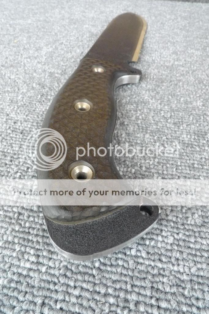

I picked this SHe up on the exchange. This knife I believe dates back to around 2000 so 14 years has taken its toll. This came with a CG coating except the spine and underside were satin from the factory.
Can I get these paper scales back to a nice rich Black color? Notice how they are a brownish/greenish mess.

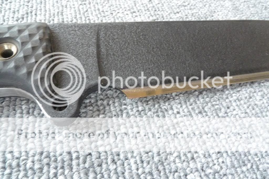

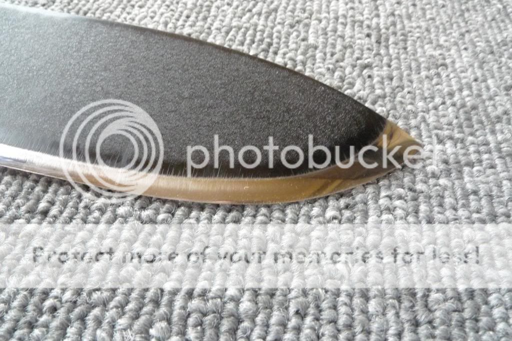

The previous owner said that the edge was convexed to a super sharp edge. What he didn't reveal is that one side is about 2-3mm more than the other. I can't see both sides at the same time, but it still bugs me :( I took her out and chopped some wood and trimmed a tree. Afterwards I noticed several chips in the blade edge, damn it must have been too thin on the edge???? I got the edge fixed on my HF belt sander, but the bad convex remains. I guess over time I will get enough experience to make it right.

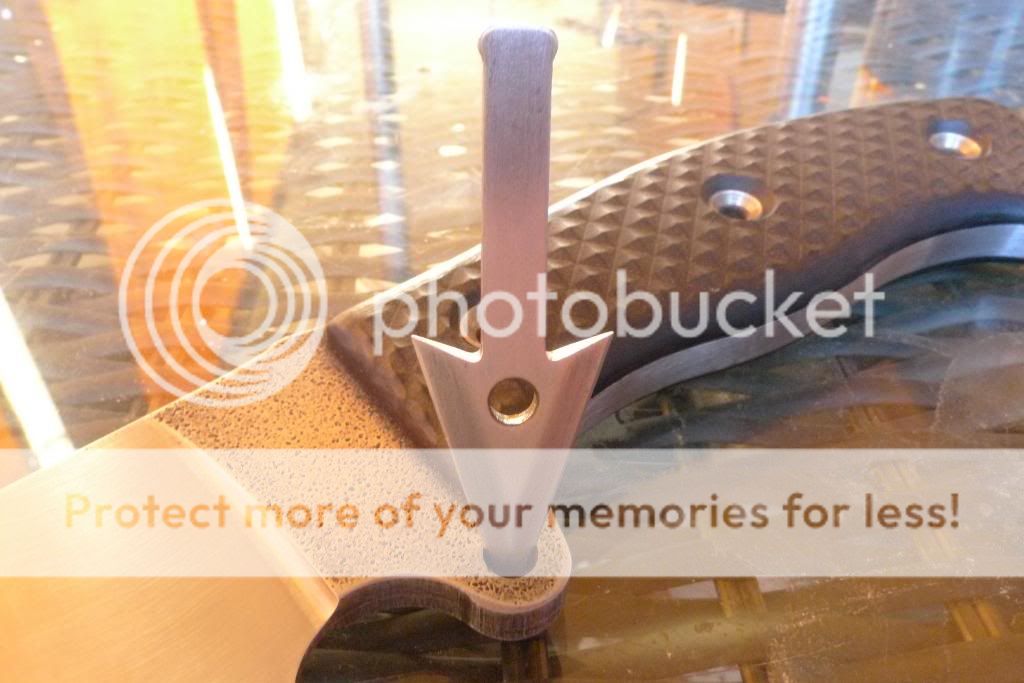

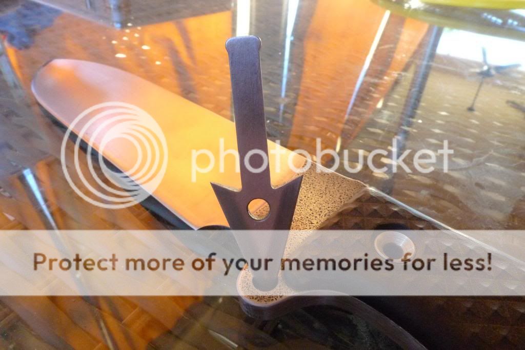

I have since stripped the crinkle coat to reveal a nice fairly smooth blade with some cool INFI pitting at the ricasso and the butt, but don't have photos at the moment.

don't let the edge difference bug you too much. These came new with an asymmetrical edge, if my old memory isn't failing me. Ground higher on one side than the other as a design feature.
Really? Hmmm - learn something new everyday - I will try some searches for more info. thanks
Found this thread - http://www.bladeforums.com/forums/showthread.php/747170-Asymmetric-Edge-Resource-Thread

The convex bevel is on the right side of the blade with the blade pointed away from you, edge down. The convex bevel is the wide one.
Just last week I was trying to find someone who could 'FIX' this knife. Little did I know it was a design feature. Slaps forehead...I have much to learn.

I have washed this handle about 10 times at least so I don't think it is grime. I think over time they dry out as the scales are no longer flush with the steel. I have used some mineral oil and it helps, but I think the discoloration will always be there.
If you talking about the spine of the knife sitting proud of the scales, then that is a pretty common thing among the older E handle knives. I've had many that were like that.

EDIT: to add, the asymmetrical edge comes in all widths. I've had some that were very pronounced and some you would barely tell the difference between the two. My long gone BAe was very different from side to side, one side twice the height. Yours is not out of that realm of possibility. :)

The edge is down with the tip away from you. :thumbup:
THe convex is the wide edge on the right side of a typical asym for a right handed user. Also, known as the reverse side of the blade or the side with no logo.
Now in your case it looks like the previous owner tried to convex the entire edge which is why its hard for you to see.
A left handed asym is the opposite which places the convex bevel on the left side.
You can send it in to the shop and they can return it to asymmetrical or make it straight with a v edge, or convex it entirely depending on what you prefer.:)

That edge is no longer factory and looks as though the knife has been re-worked a bit.
The spine and work around the handle does not look to be done at the factory, I have a had a bunch with polished spines from Busse and they do not look like that.

You could call or e-mail the shop to fix up the edge I know any of the great folks there could put a razor edge on it.
I would say that is a great user, collect-ability other than being a nice E-handle Busse has been lost on that one with grinding and stripping unfortunately .

The scales, I would have different ones put on, I am not a fan of black paper for this reason, I have had a couple do this same thing or lighten up to grey and I have not found a way to get them back to deep black.

That's my old knife. I put that edge on there. It's no longer an asymmetrical grind. It's a lean and mean convex. I also rounded the corners on the handle slabs. I don't know how many owners it's been through since me or how they maintained that edge but when it left me... it would shave a gnat's ass. And it wouldn't chip even in super dry hard wood.

That knife looks pretty good as-is. In my limited experience with paper micarta on Busse knives, it has a slight brownish-greenish look to it even when new. Regarding the scales not being flush with the metal, this was somewhat common back then when knives shipped new from the factory (whether paper or canvas micarta); I doubt that it is due to shrinkage. If you decide to get new grips, I recommend canvas micarta for a knife that will be used. Congratulations on a nice knife!
