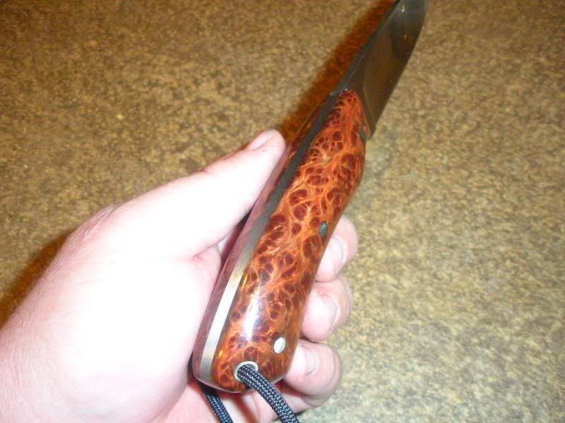

Hi folks! Just thought I would share this with you guys since I got the finishing touches put on it earlier tonight.
This is knife kit #3 for me, and my first 'order'. It's for a guy I work with that seen my first 2 knives and asked if I would make him one too. We decided to end up with a trade instead of money. I needed a muzzleloader; he needed a good hunting knife. I got a CVA Staghorn Magnum w/ scope and he's getting this. I think we came out pretty good.
The blade is 8A stainless steel measuring overall length is 7-3/4", the blade is 3-3/4" long and 5/32" thick. 320grit brushed finish by me. Don't care for mirror much. Pins are stainless and both pin faces and blade edges were left rough to match the brushed look.
The handle scales are redwood burl, finished to 2000 grit then 6 coats of Tru Oil rubbed with 800 grit between coats. Lanyard is paracord and will be getting a carved bead from a piece of the scrap I when I cut out the handle shapes.

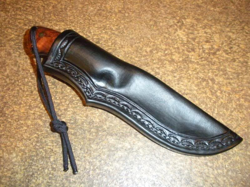

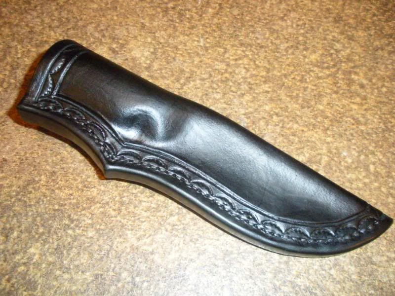

Sheath is 8/9oz veg-tan leather from usaknifemaker.com. Simple pouch design with only a border stamp used, wet-formed. Light distressing to give a slightly aged look. Hand stitched. Dyed using Fiebing's Pro Oil black. Finished with a couple coats of mink oil worked in with a hair dryer.
Hope you enjoy looking as much as I did working on it!
