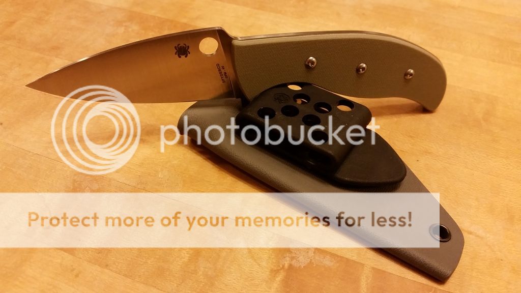

i use a glockcrazz kydex one i got made. works great. i also use the halperns.
I have seen those on ebay before, but no first hand experience with that combo. Sheath has a larger footprint than the Glockcrazz.

And I should mention, the Spyderco G-clip is great and highly under appreciated and under mentioned here!

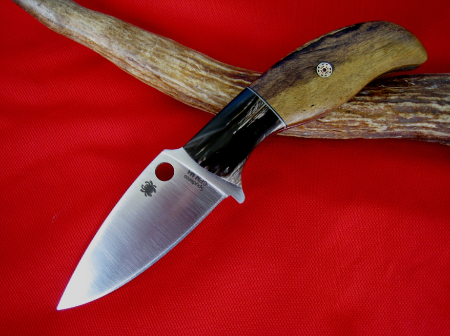

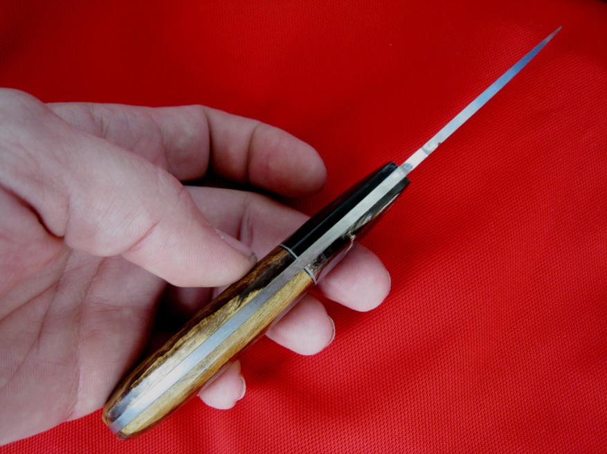

Here is one I've made myself a few years ago. Horn and striped ebony, hidden studs.
Thinking about making a few more of these: have got a number of blades accumulated over the years.
Sorry no sheath.
