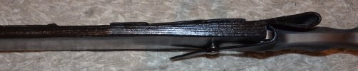

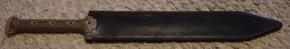

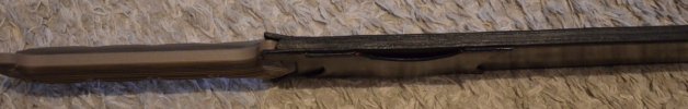

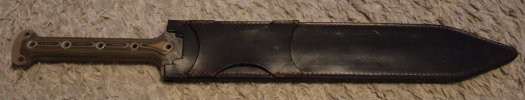

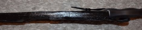

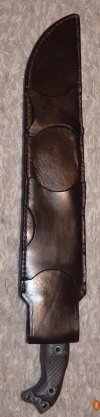

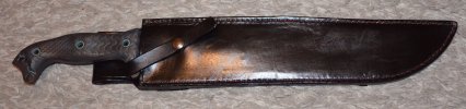

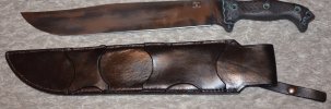

tried to raise difficulty and made this now.
A MOAB needs a mother of all sheaths (for me yet at least)
im not sure yet:
edge coating at end or not
what do the profs think about that?

I'm not a fan of edge coats, to me they look plastic and gunky. Makers use a variety of finishes for edges like Gum Tragacanth, saddle soap, and some use simple wax. Both are buffed into the leather while damp. Key to good edges is lots of sanding and truing the edge to 90 degrees. Your edges should be smooth and even before you even begin to add a finish of any type. Round those corners off as well.
Way over simplified, but I hope you get the gist. Please feel free to ask any questions you have, I love talking leather. :)
Thanks leatherman leatherman , im not a edgecoating fan either, as you said, it looks like plastics and at my point of view not really natural.
i think i new a more fine sanding grit on my machine, would make it a bit smoother
Well im working on it, but i think ill figure out the ways to get better, still loads of sheaths to do.
Atm im not really sure where this journey goes.
Jerry is setting up cool new blades faster than i can spend time making sheaths, so as longer it goes the more sheaths i have to do :confused:

Everyone does edges different I'm sure, I follow Paul Long's advice on his DVD's for the most part. I true the edges up with a belt sander and a worn 120 grit belt then hand sand with 220 then 400 grit followed by rubbing it down with saddle soap and water using a piece of T-shirt. That seems to pull some fibers up so I hit it with the 400 again then another rubdown of saddle soap. I don't go for a glassy mirror finish personally.

Is there a sewing machine that punches through all that leather or are the layers glued then drilled and hand stitched?
i wished id find a stiching machine would take me off that work !
Atm its drilling and handstiching, pretty painful when you tie every stich hardly on to get a tight result
Glued, drilled, and stitched. Had a machine and hated it with a passion. The only one I actually liked was the Tippman, never should have sold it.
