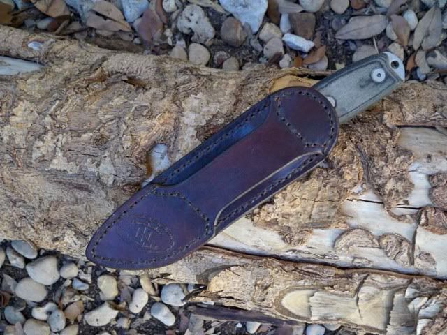

Hi Dixieblade57, that sounds like a beast of a knife!
Heres what I do for cross draw, this one doesn't have all that much angle to it, but its easy to design one that has more. Just increase the angle till you have the desired cant of the sheath.
Others might chime in with a better system, we've got some talented makers here. :)

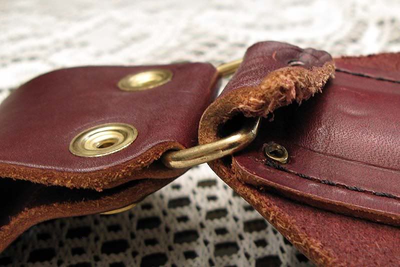

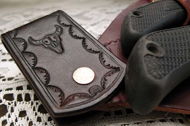

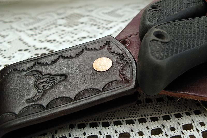

and another option that may help when carrying a large knife like that is to have the sheath swivel,
Rob Hudson would make his sheaths in that manner, the belt loop part would
be attached to the sheath via a thick copper rivet. Works great!
I repaired a guys sheath that was torn, had a D-ring on there and the stitching tore
apart, not my original sheath mind you, but one that came with the knife or rather set of knives.
here is a before and after shot of this repair job I did for his sheath;
so it allows the knife to swivel up and out of the way when you go to sit down.
