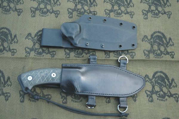

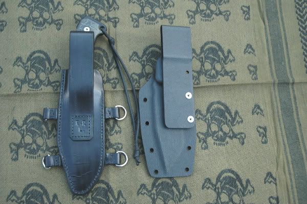

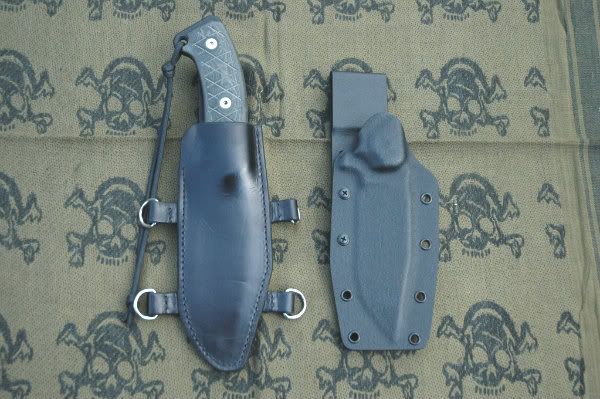

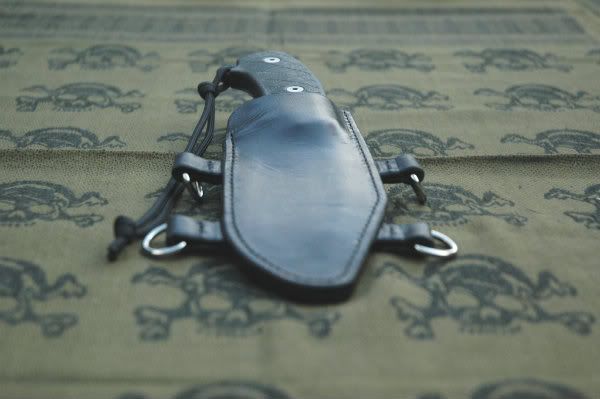

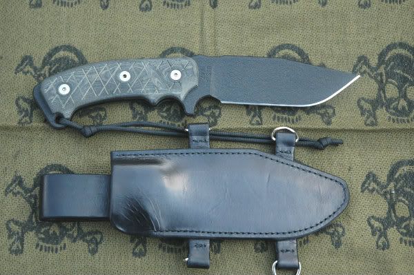

Hello All,
Just picked up a Fehrman Last Chance, it came with a Kydex sheath which is fine, but I like making leather for my blades also. I saw the stock version with lashing rings and thought I would give it a try. This is my interpretation of a belt/pack carry sheath. It is set up to lash easily to your pack or just belt carry. I did not use a retention strap on it, did not need one with the wet molding and the tightness of the sheath it will not go anywhere, I can hold it upside down shake it and nothing moves. It's made from 8/9oz double shoulder leather, Fiebings black dye and conditioned and waterproofed with Montana Pitch Blend dressing. Hope you guys like it.
Very nicely done, my friend. Nothing against the kydex, but I do like the looks of your leather better.
Paul
Beautiful work! Would look dandy with my Last Chance riding in it that's for sure ... LOL. j/k. Seriously though, wish I could find something that nice for mine that didn't cost a fortune and don't have the time to attempt it myself.
How do you like the knife? We don't hear enough about the Fehrmans on here. I am thinking of getting one.
Thank you very much, Im sure yours would fit like a glove in this.
Brother I love it, if your thinking of one you wont be sorry at all, it's build for serious usage. it's working it's way up to one of my favorite blades.
