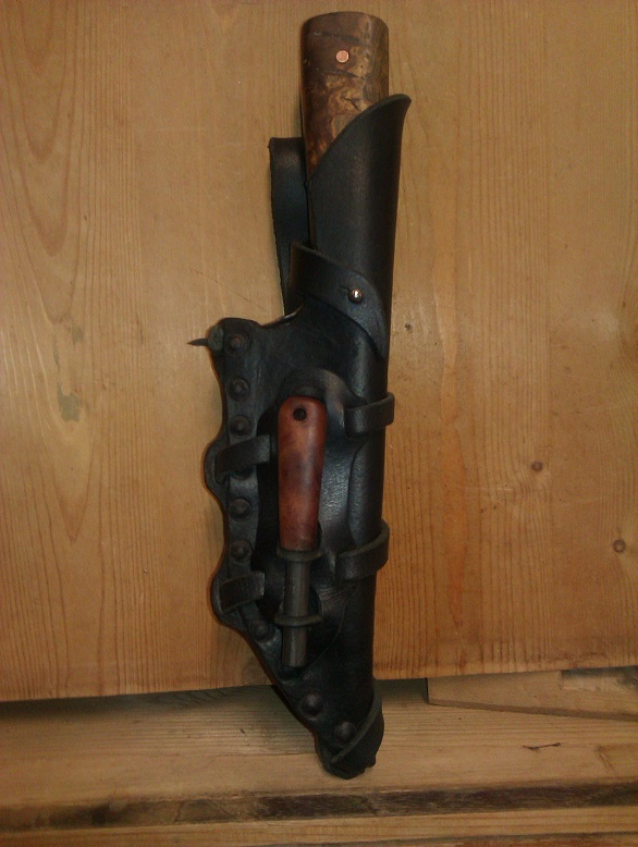

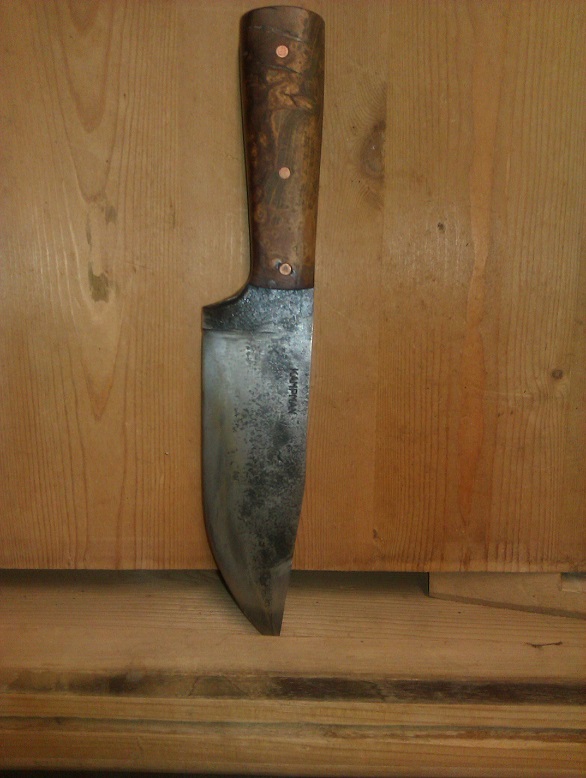

sheath in raw-styl for a bruteforged Kampman knife

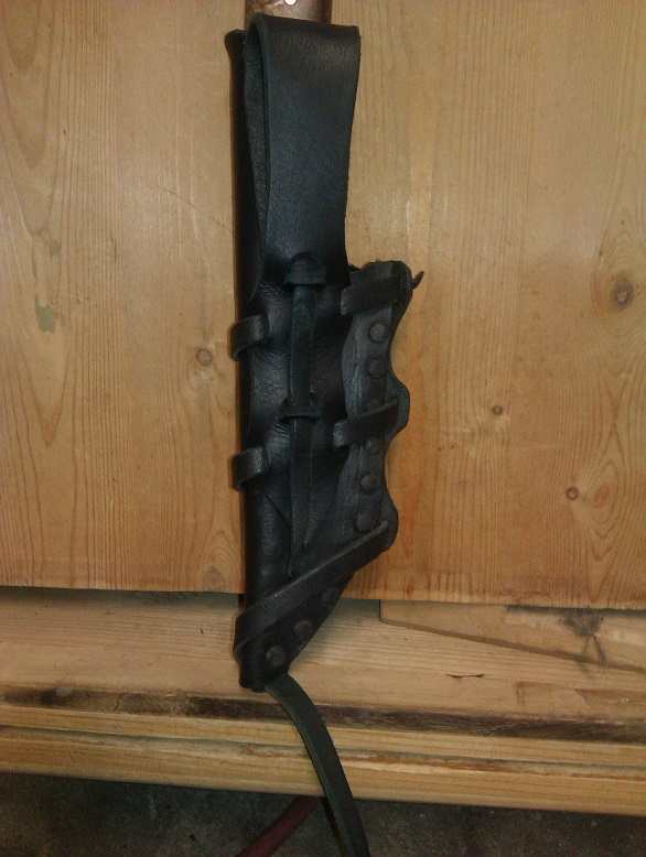

i tried to make the sheath in a fitting style to the knife, it is made without glue sewing or pivots, JUST leather and a stud.

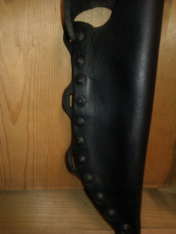

instead of the sideseam i used leather plugs to mount it, the strap and the beltloop are mounted with harpoons
Interesting design. I guess am not that familiar with leather plugs. Do you hammer or press it together? Anyway cool design for thinking outside the box.
thx gadsden, you get the plugs when you draw a soaking wet strap of 4x12 mm leather through a 3 mm hole in the leather, (with an awful lot of violence),when the stap is through it is almost dry and you can hammer a mushroomhead on it.Btw the sheath is made without any machines too
Very cool. I may have to borrow this design soon. I'm a sucker for age specific design.
