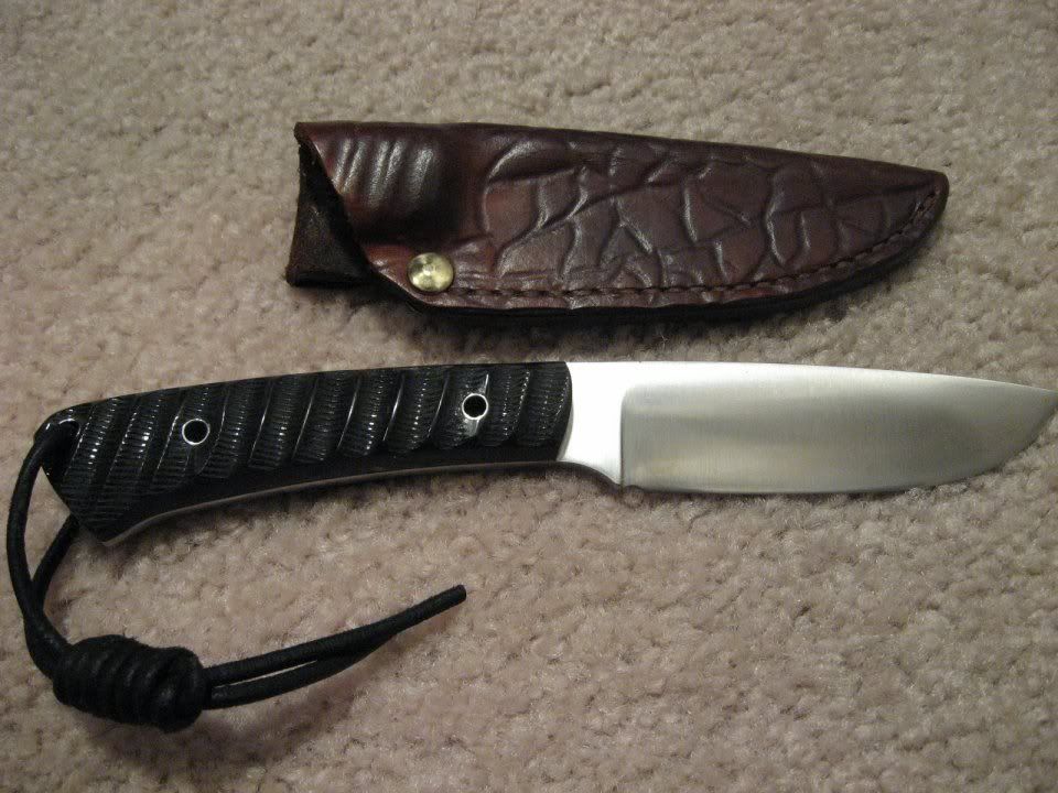

Somebody please give me their thoughts, whether from hands-on experience or something you read or just believe. I want to know what to use to get that "oil-tanned" look and feel.
I'm making a new sheath for a Barkie. I admire the Knives of Alaska sheaths which have no sheen - they're oil finished. That's how I want to finish my new sheath.
What do I use? Mink oil? Neatsfoot? Are there specific oils to use? I want to avoid that glossy sheen I get with traditional leather "finish and protectant".

Here's an example of heavy and light applications of Super Shene. The black sheath pictured first has a couple healthy applications of Super Shene over unoiled leather. The result is pretty firm leather that's very well sealed.
This second sheath was dyed, then oiled with neetsfoot, then given 2 extremely light coats of Super Shene. In my opinion this one has a much less shiny finish; I like this look too. Due to the oil it has an added supple feel about it which is nice.
If you want to go less shiny than that last one and still have your work sealed, I'd like to know how, too. :thumbup:

Thanks Mikey! Good info. I like that second sheath - that's the sheen and color I'm looking for. What dye did you use and what did you use to make the dimples?
Here's one of several I made. I like the color and sheen, but now I want to experiment to somewhat replicate the KOA sheaths..... kindly like yours.
Stretch, it's always wet form first, let dry completely and then oil. If you will flash dry it with a hair dryer it will harden the leather some which in the case of wet forming is an advantage. I am not much of a proponent of dyes, but if you will dye right after you oil the oil will carry the dye into the fibers slightly more evenly.
The dimples you referred to in the other man's sheath were done with a tool called a pear shader also available there at Tandy in ABQ.
No problem. :D As Paul surmised, the pattern was stamped on, before wet molding or doing any dye or finish work, using a pear shader I got from Tandy. You'll note at the top of the stamped area under where the retention strap covers the front the stamping lost its crisp detail when I later did the wet molding. I tried to fix it up but it didn't turn out optimally. I'm still pretty new at this, too. :thumbup:
The dye is Fiebings British Tan (my favorite color so far) I got from Tandy. I ragged it on wet leather. The ragging (instead of daubing it on) produced the nice saturation on the ridges and less color in the deep stamped valleys. I like Paul's idea of dying on oiled leather for more even coloring; I'll have to try that.
So in short, my process on that sheath was:
. . . work on sheath with all pieces separate . . .
Wet leather of top/front and bottom/rear pieces
Tooling (the pear shader and grooving and whatnot)
. . . work more on sheath including final assembly and edging. . .
Wet leather
Dye
Let dry
Buff
Wet leather
Mold to shape
Let dry
Oil leather
Let soak in
2 coats Super Shene
Let dry
Buff
