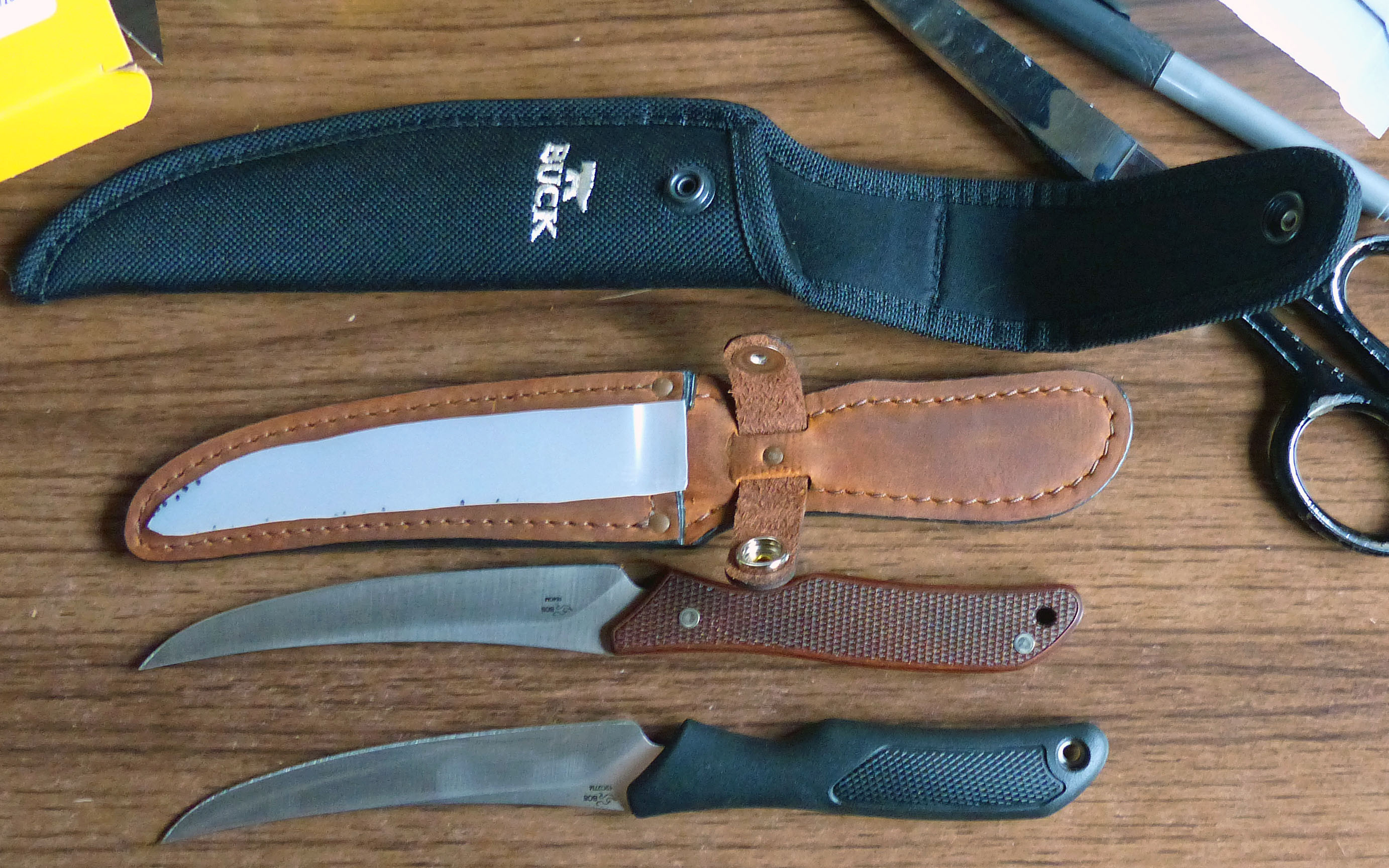

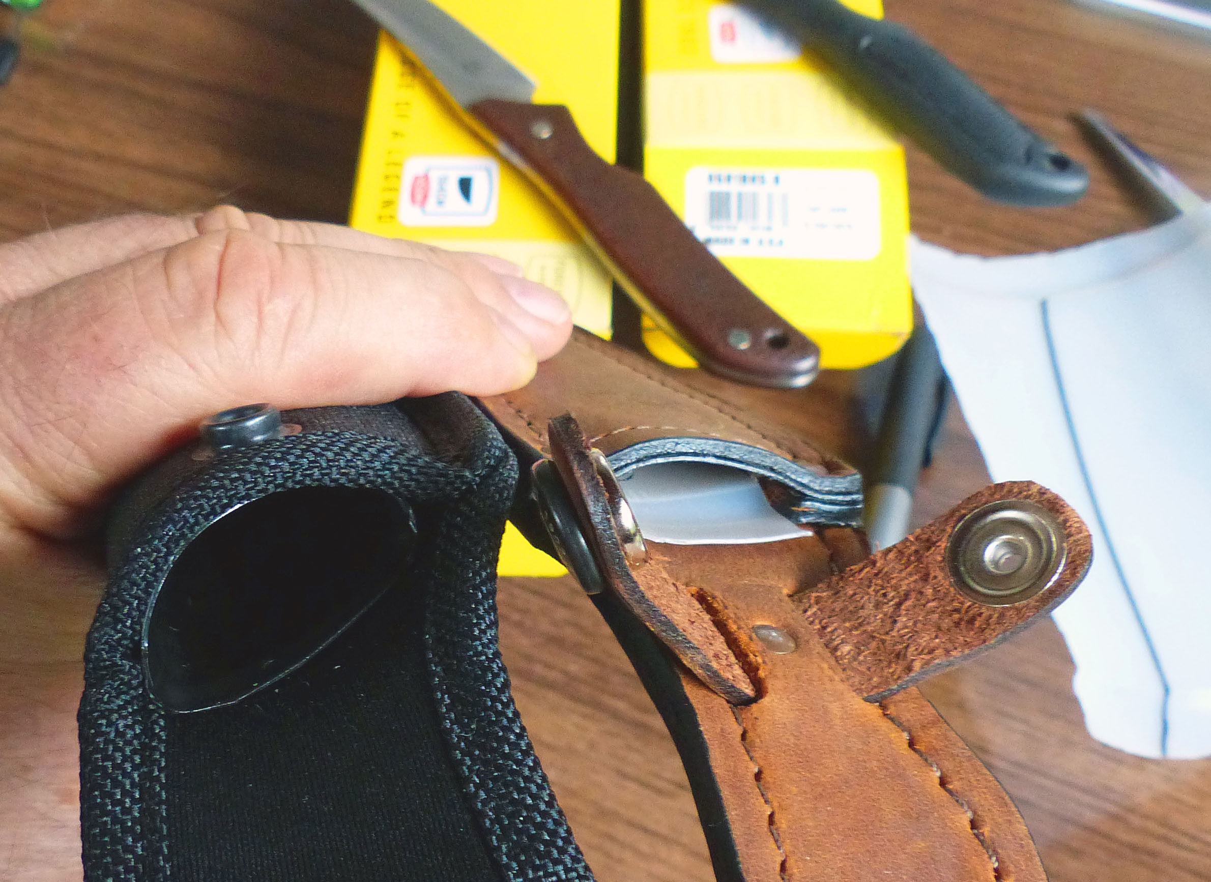

I pierced the thin leather back of my brand new Boone & Crockett boning knife model #583 Build Out sheath simply by replacing the knife into the sheath for the very first time.

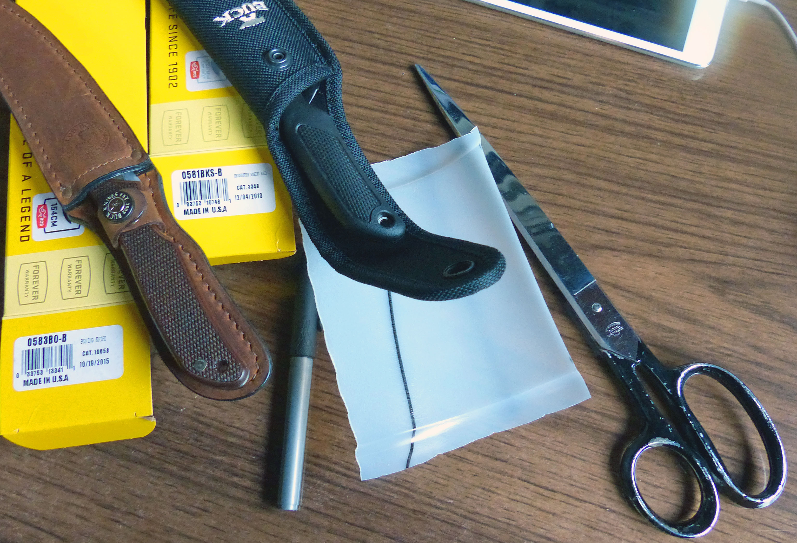

Unlike its nylon-sheathed brother model 581 boning knife, which has a terrific resin liner, this fancy Build Out model has no liner. So I made an abbreviated liner out of some plastic from a jug. Here are some photos to tell the tale. I used a marking pen, scissors and small serrated knife to cut and trim the white plastic piece to fit deep into the leather sheath. You could also use heat (heat gun, boiling water, hair dryer, etc.) to shape the plastic as well if necessary. It still takes great care to put the 583 back into its sheath even with the liner but no piercing.

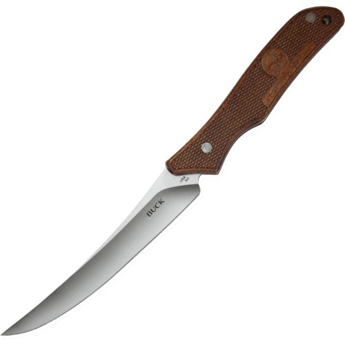

Yes Desert Dave, the fancy Boone & Crockett wood one has the 154CM steel that cuts and pierces real good with its 5" blade. The rubber handled version also has a 5" blade and it cuts little tiny bits of black plastic off of the inside of the sheath liner every time you insert and remove the 12C27 sharp pointy blade. The woody came from Web Specials (all gone now) delivered just yesterday and the rubbery was purchased at the BCCI 25th years ago now (bot 2 then).

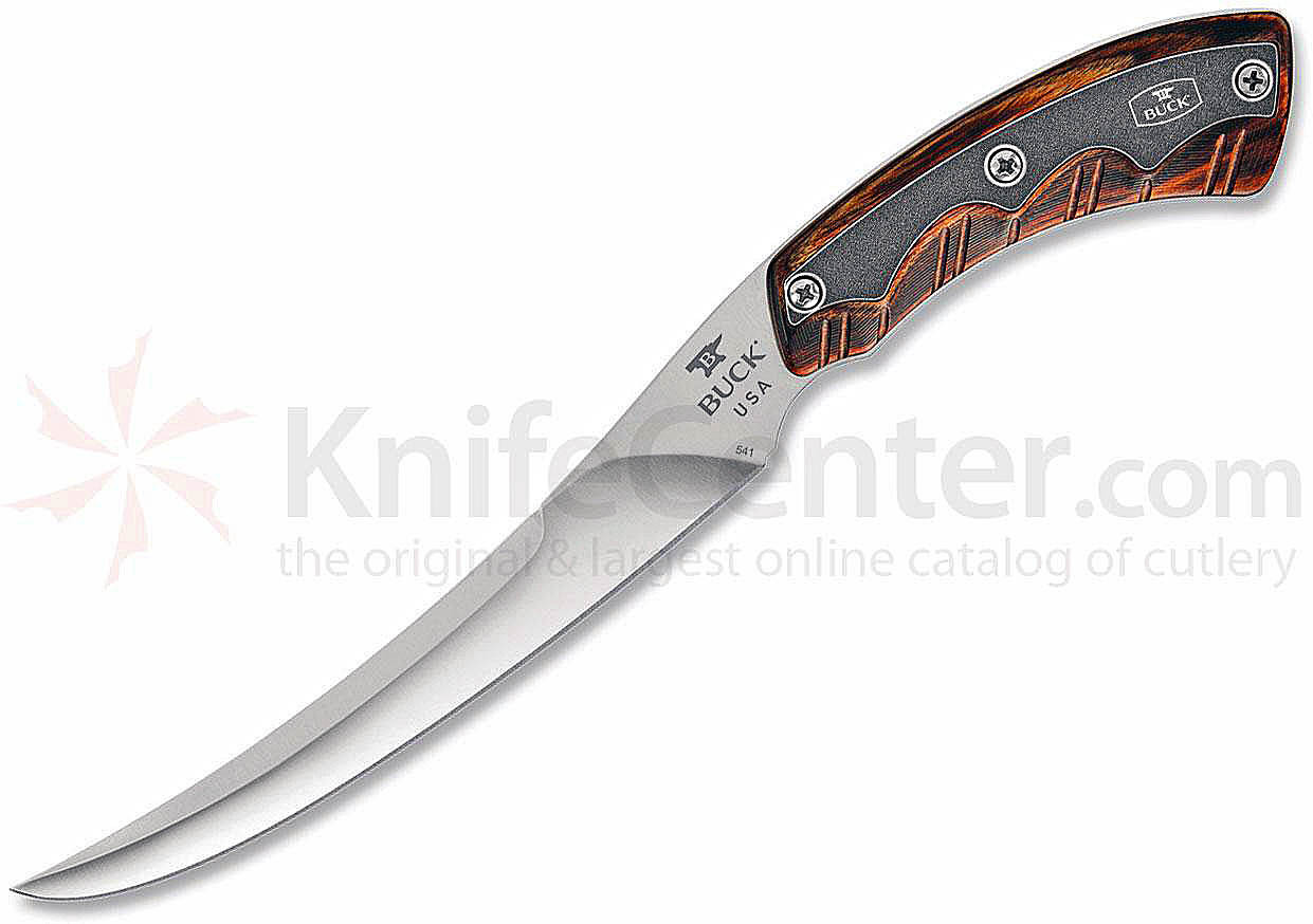

Boone & Crockett can be pretty fancy pants some times I know. But look. Why not consider the new 541 RWS with wood S30V 6.5" blade black leather sheath (liner?, see me if not for the fix) and USA:
Ok, have you held and used this 541? How does it work with the handle at a different angle than the blade? Is that a top swedge on the upper length of the blade? Then the center line has the thickness. 6 1/2" is a good length. DM
