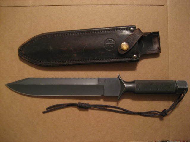

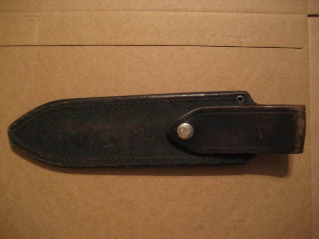

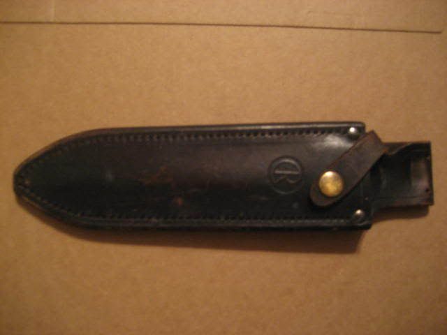

Nyefmaker, does that sheath really look that good (used) or is it just the picture. It looks fantastic!!!!!!!!!!!!!!!!!!!!!!!!!!!!!!!!!!!!!!!!!!!!!! I love broken in leather.
T
The Sheath is in Excellent Condition and looks even better in person. This is an old CRK too. I just purchased it. It is a Jereboam I with the Sawtooth Back and was made in South Africa. My Chris Reeve "Holy Grail" I will have to post some pics in the next day or so.

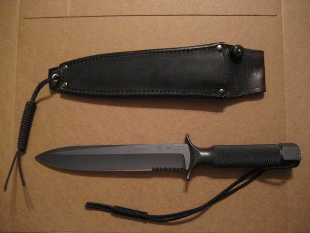

Here are the pictures as Promised, Enjoy !!! I even threw a picture of my CRK Pachmayr with Original CRK Sheath !
