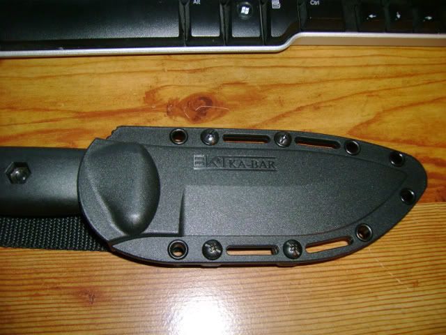

On the subject of the sheath, I just got my BK2 and I have the sheath with the BK KaBar writing on it....Is this the gen1 or gen2 sheath???? I already notice it dulls the edge. Thanks
we could guess, but a picture is worth a 10000 posts.

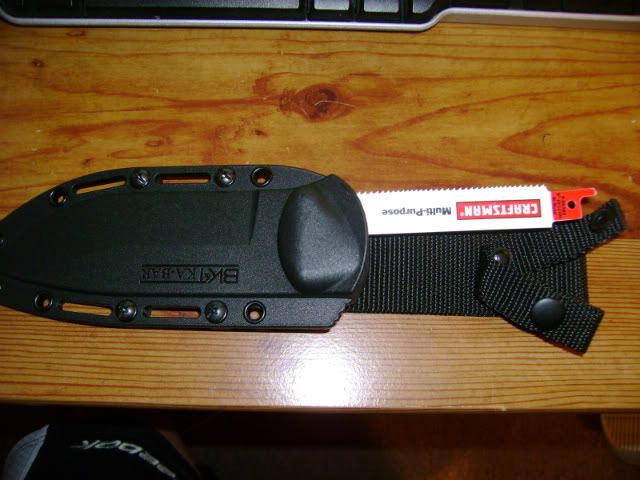

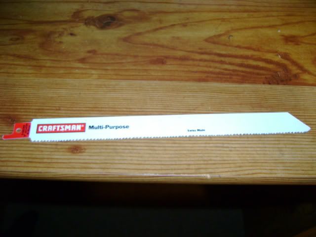

I think I am going to try to get a pointy wood saw and rake it in and out until I remove a little of that plastic on the inside. I bought 2 from amazon, one for me and one for my brother, and they are both like that. I still love the knife, and I love my BK9 too, so no Becker basher here.

that's probably gen 2
take it easy with the saw. go slow.
you could also sheath and unsheath the knife after a few hundred times to "break it in"...
could also say, rub a sharpie (carefully) on the edge, and see if that's rubbed off, and if so, use the saw a bit more.
let us know how it goes
Bladite

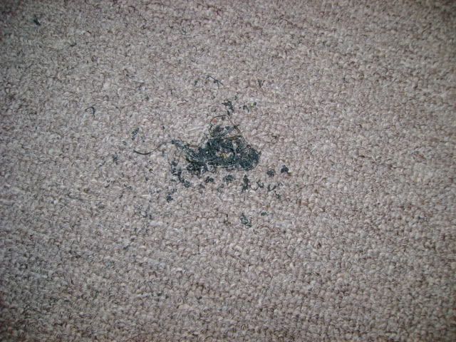

Here is what I tried. Reciprocating saw blade works good, seems to be plenty of extra plastic there. I put some marker on the edge of the knife and tried it, didn't seem to rub off the marker. I will resharpen and see for sure....
Plastic shavings taken out

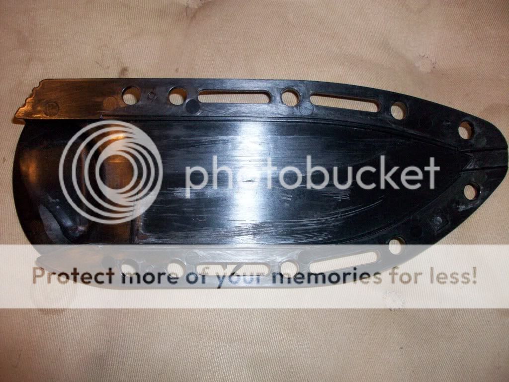

I disassembled my "stock" kydex sheath to see what was going on, it seems that the thicknesss of the blade forces the sidewalls of the sheath to swell ever so slightly, causing the area the edge is closest to, to draw up into the edge. But there are definite cut marks on the inside of my sheath. I will post some pics this afternoon. Moose.

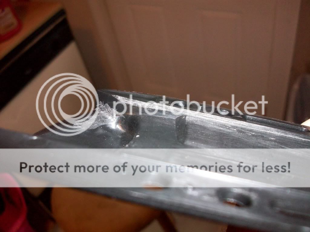

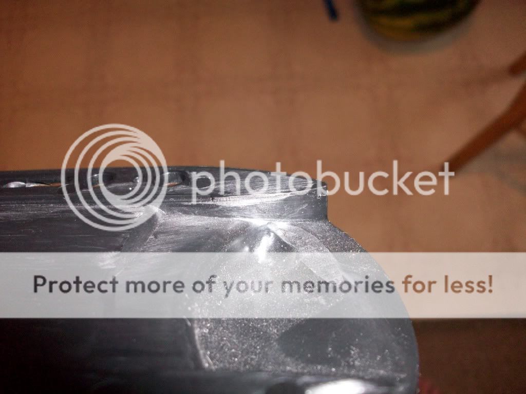

I apologize it took so long, been busy. Please, please, understand, I am not a pro photographer, and I am trying to capture something hard to see with the naked eye, much less a Kodak camera. I am no engineer, but I understand physics, and I am very observant, so without further adue......
What I want to point out is the rub marks (striations) located near the "bucket" opening of the sheath, they are DEEP rubs that come from the spine area of the BK2. Located under the 1st hole, top left.
This is a pic of the area that the edge digs into when you retract the BK2. Its about 1/32nd of an inch deep now, as I did alot of resheathing while building the prototype sheath I was making

This the other half of the sheath, the "male" side I call it. It show obvious sign of wear. Now, I'm not bragging, but I make my edges RAZOR sharp, throughout the entire edge, and when I would sheath and unsheath my BK2 once, it had been diminished, all the way down, except where the spine thins out, which just so happens to be where the width of the blade diminishes as well. What I can't show is also that the sheath halves are bowed outward from one another, I assume a manufacturing side effect. There is a male half with taps on one side and female slots on the other where the sheath fits together, on the male tabs is where the most damage can be seen. If you look, there is no cutting on the male tab anywhere else down the inside. I also believe that the swelling of the "bucket mouth" when you retract the blade aslo causes the same effect as the blade swell, because I noticed the edge of my BK2 was "duller" closer to the scales, caused by the massive deformation of the sheath as the scales slipped their resting place while "in battery". I would very much like someone elses opinions on this, and if you feel that my observations are in error, I completely understand. Thanks to all. Moose
Oh, I did some minor alterations to the "lock in" in the bucket, so that is not from rubbing, just me trying to loosen the pressure during withdrawal to see if the blade still bit as deep in the sheath. Thanks to all. Moose.
