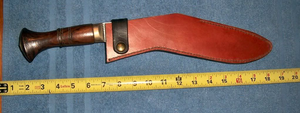

Here's one I did for a little Chainpuri. The disadvantage of this design is that you must be careful re-sheathing the blade to keep from cutting the retention strap.

Sharp knife to cut the leather. Stiching wheel (marks the stitching spaces)
an electric drill (to put holes through 3 layers of thick leather), heavy waxed thread and heavy sewing needles, leather dye, snaps and snap setter.
A small drill press would make drilling the holes a lot easier. Some sandpaper to help smooth the edges of the sheath before dying and finishing. Oh, and some good ole grease of the elbow!

8-9 oz.
The biggest challenge for me in making mine was getting the holes straight through several layers of leather. A drill press would have made it so much easier, but alas...

OH, be sure to make a pattern from cardboard before you start cutting leather.
Cardboard is cheap, leather isn't. ;)
