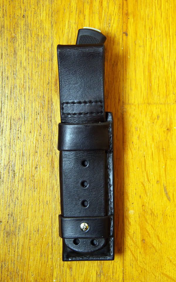

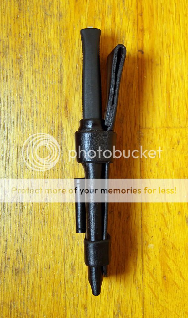

This one for the Fällkniven has a removable loop that makes it suited for horizontal beltcarry. It locks up in a kydex liner, and doesn’t need a strap with normal use.
The loop attaches with a screw, and fits a teklok. It can be carried high or low.

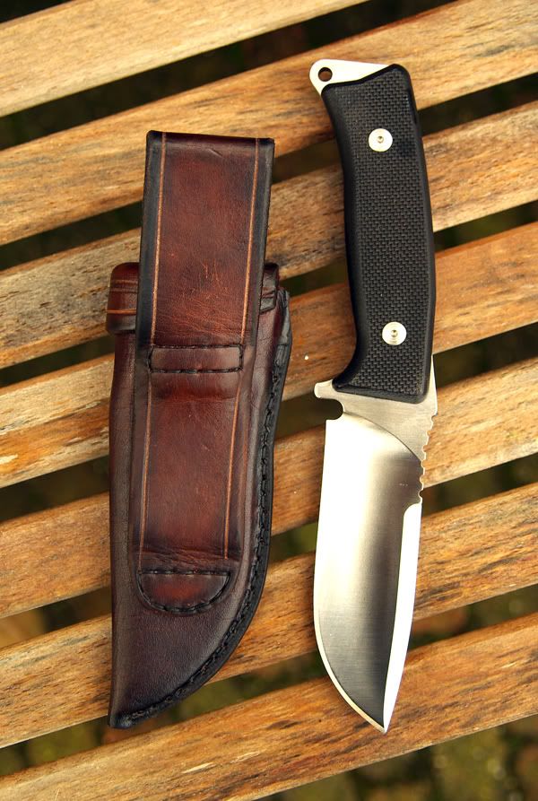

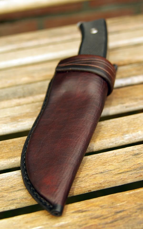

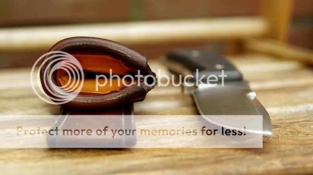

This pouch for the ‘Tito’ by Nexus Knives has an inner of 3mm halftanned, skinside in, and a shell of hard and tough lappleather. The locking weld is made of 3 layers of lappleather, glued, sewn and polished to a kydexlike lockup. The toprim is folded over for added stiffnes and durability. The sheath was meant to be black, but the owner changed his mind last moment..

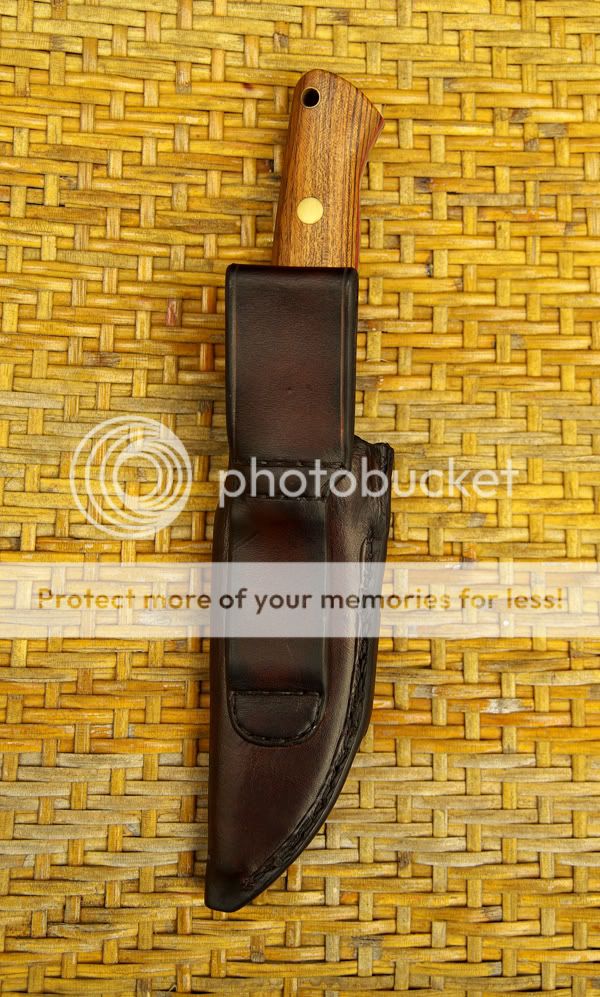

BRK&T Bravo-1 sheath with 1.25” kydex liner and a weld of lappleather.

Beautiful work as always, Martin. I've said this before, but I'm really starting to like square bottom sheaths.
I also really like the look of the Tito. Do you know much about them?
Doc

Thanks again, Martin. It was a fun project. I'm turning a handle out of aluminum for the firesteel. I plan on anodizing it black.

@ aarong .. It's the Tito, by Nexus..
