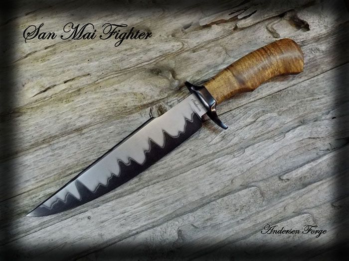

Give the blade a mirror finsih and then get it hot blued, not cold blued (big difference) It will look black and shiney. I know Karl B Andersen does this on a lot of his guards and on his damascus, and with a mirror polished spine like he does often on his blued damascus blades, it just looks sooo nice!
Here is a perfect example of what I'm talkin about, look at the mirror polished spine on this hot blued blade.

Hot Blued mild steel guard and blade, but only the carbon steel core on the blade is able to blue since the sides of the san mai are made from stainless which doesn't react to blueing

The blade on that San Mai is not blued. It's etched 1095.
But the guard IS blued. And it would look exactly like "black chrome" if it was mirror polished but it is a satin finish.
