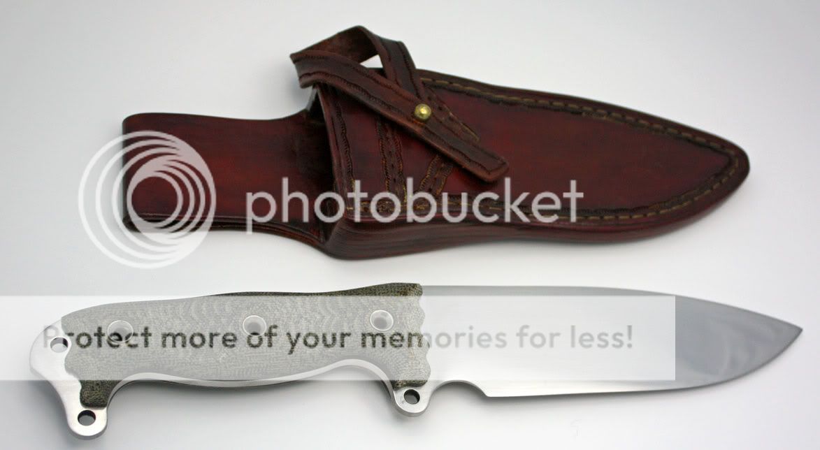

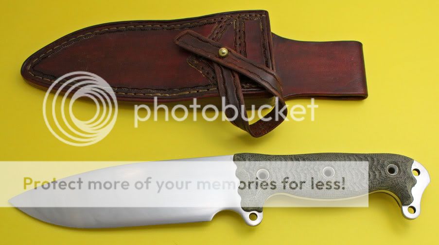

I think it actually turned out okay!
Black to ugly to shiny (satin).
Full convex with just the edge left to do. It definitely wasn't one of the easier blades to work on with all the deep machining/grindng marks.
Cheers,
Dave
I used a grinder.
Oh, and the "marks" on the blade are reflections of wrinkles in my special light dispersion material.

Many thanks. I have done the exact same convexing of the blade on my Skinny Ash but want to remove the handles to give a uniform finish on the choil and pommel. How did you drill out the rivets? An overhead drilling rig or a milling machine? Did you experience any difficulty with the rivets? Did they hang up on the bit ? Did you oil the inside of the rivet before drilling? What type of steel was the drill bit?
Hi Peter,
I used drill a press and had no trouble. I've finally started to clamp everything I drill. The last horror story did it for me.
I tried a .25" bit but must have gotten off center or something and it left the rivet hanging on. I switched to a slightly greater than .25" diameter (no oil, cobalt bit but would have used a cheaper one if I'd had one) and just drilled until I felt INFI. The top of the fastener stayed on the bit and slid off easily. I punched out the part in the handle and that was that.
I did several blades at the same time and I think maybe one rivet spun. I adjusted its fit with a hammer and drilled the other side without incident.
