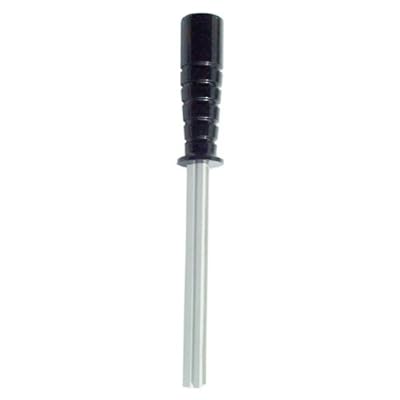

I use one of these DMT triangular sharpeners, it has three different sized angles for different sized scalops and then I use my Edge Pro on the other side. Works great, though they never look "like new" again.
