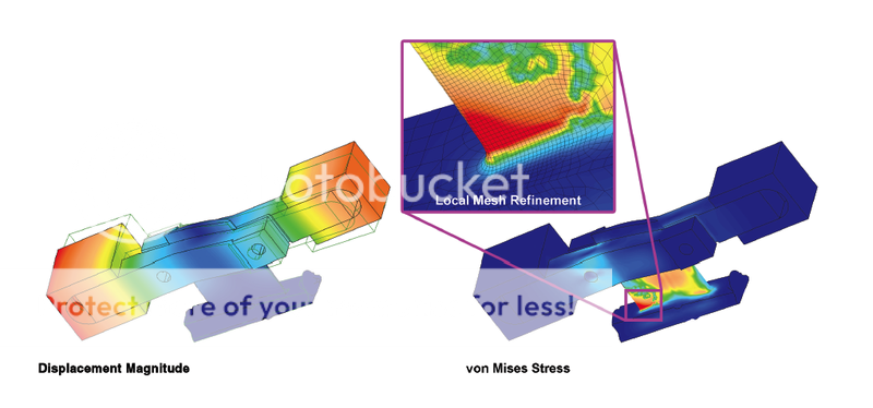

It would probably surprise many to see a FEA stress model showing a serrated blade versus a non-serrated blade with the stresses resulting from the same displacement.
Since FEA of stress could show us the locations cracks would likely start, namely the areas of greatest stress (if we only knew the displacement from the impact) I think some finite element analysis pictures are in order (Thank God we do use real science to design and investigate failures for some very important blades - turbine blades).
Why would this suprise people?
Everytime I used a FEA program to determine stress areas, the highest stress was rarely somewhere I didn't expect it to be.
Even in the above shown example, one would expect the blade root-to-center hub junction to be a critical area, with the area of thinnest material receiving the greatest stress.
What are you showing in the picture, interpret for us please.
Blue means no stress, red means max stress, yes?
Red is max stress.
Broos is posting the results of a Finite Element Analysis of a blade segment.
In the left picture, he shows that the blade segment is clamped and appears to be being torqued (judging by the shadow figures above and below the clamp).
I will use words,
To form a pressure wave, the impact has to be moving faster than the medium can deform. Steel can deform faster than any impact from a manually driven hammer. So there is no "wave" formed in the material. The steel just deforms as if in static load.
