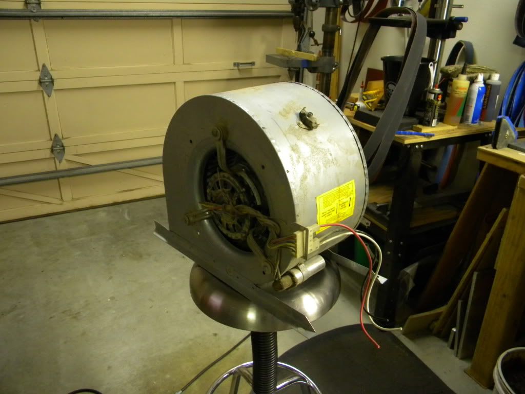

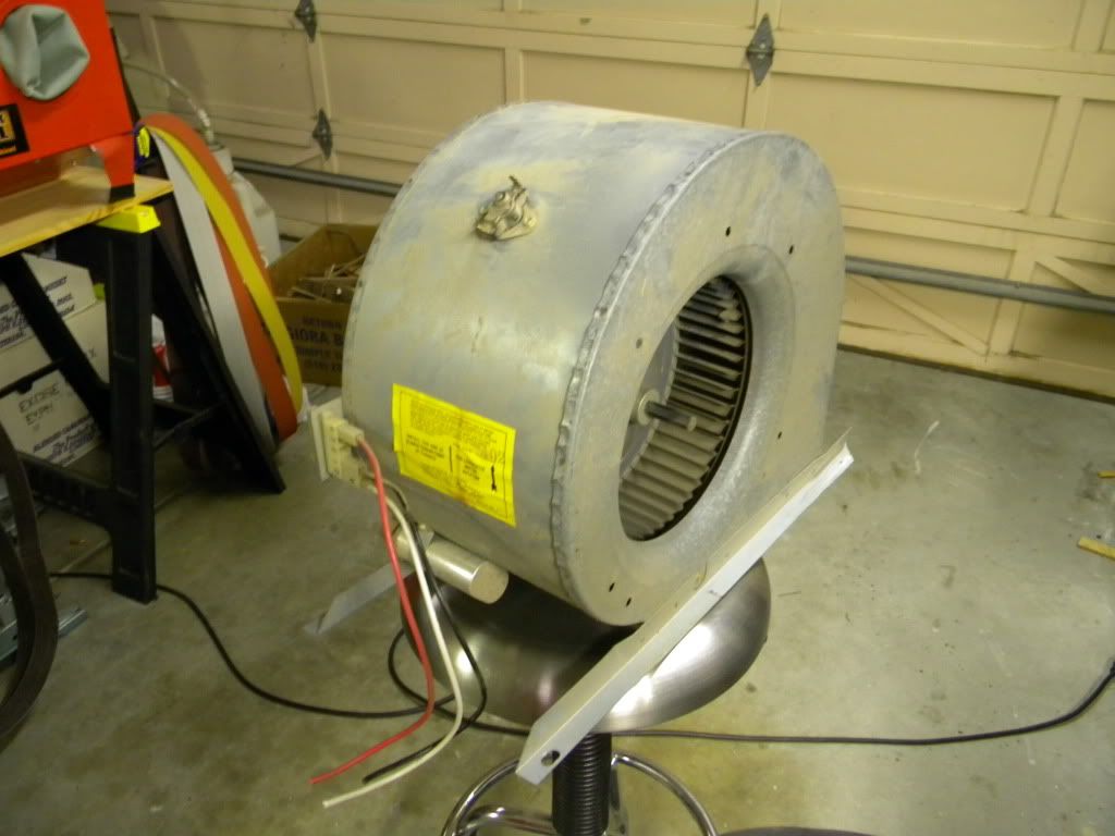

Anybody remember the thread a while back about building your own air cleaner for the shop? It had plans using a squirrel cage blower motor and plywood to make a box with a slot for a furnace type hepa filter.
I've looked at the models from Grizzly, Jet, etc. and they're really nice but I've got other things I could be doing with three hundred and some odd dollars right now in the shop. I have a buddy with a HVAC business who scored me this nice big squirrel cage blower motor assembly, so I want to find that thread to refresh my memory as to the setup of the unit. I'll get this wired up to a plug and a switch and hope to be sucking cleaner air soon:thumbup:

You're right, not the one:D I have used that exact setup with some success though. I have a box fan set up like that with a filter right behind my grinder that sucks up some of the stuff that doesn't make it into the bucket or my homemade dust collector. It does okay, but I want better. The intended purpose for this current project is to really rid the air of super fine stuff just floating around. If I recall the plans I saw a few months back here had great pictures and dimensions. I meant to subscribe to the thread but forgot.

Oh, I think that might be it!! Thanks buddy! Yep, I think something like that will do the trick. I don't need the spark trap, this unit will be mounted hanging from the ceiling and will use a high quality HEPA filter to collect super fine dust particles from the air in my shop.

If that's the case you can move the slide rails for the filter out towards were I have my 4" port and cut a big hole in the side to expose as much of the filter as possible. Post pictures when you finish!
