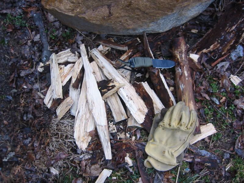

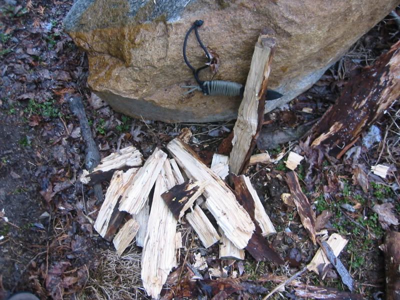

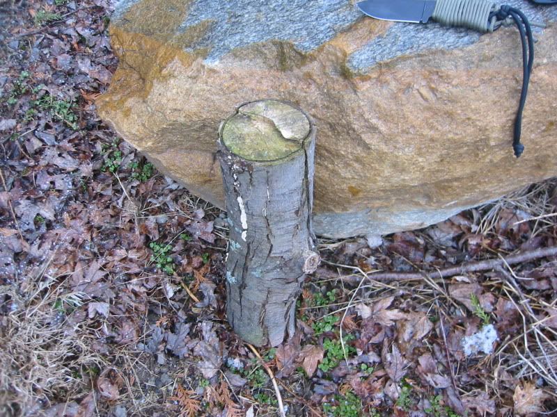

Anyway, the 11 is done. I'll try it out and report back, but I really cannot see that it will be much of a difference. Like I said, though, it's just a few minutes on a stone away from being a bevel again!
Well, the only thing I could think of to do in short order in failing light was to turn a 3" red maple log into kindling. This took less that 5 minutes. Not really the ideal task for an 11, but it performed wonderfully. So, the convex edge didn't do it any harm for sure, and the edge is still quite there!
