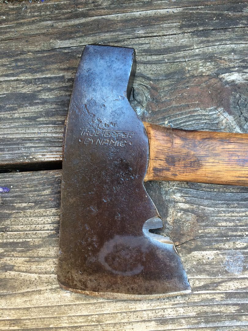

I found this at an estate sale today. True Temper Dynamic with original True Temper "fire hardened" handle.
I don't know about the Keen Kutter versions but the True Temper Dynamics came with slightly curved handles. IMO the handles are too short for the weight of the hatchet. They would be better served by a 17"-18" straight handle.
The little bit of octagonalizing on the back of the haft near the shoulder was typical of most, but not all TT Dynamics. If you find the octagonalizing then you likely have an original haft.

I thought it was funny to post the photo too, because it is not a flooring hatchet and has nothing to do with the thread or the question it asked.
As can be seen by the original example in the photo I put up, It was silly of Square Peg to assume that TT flooring hatchets had "slightly curved handles" just because a completely different style of TT hatchet does.
