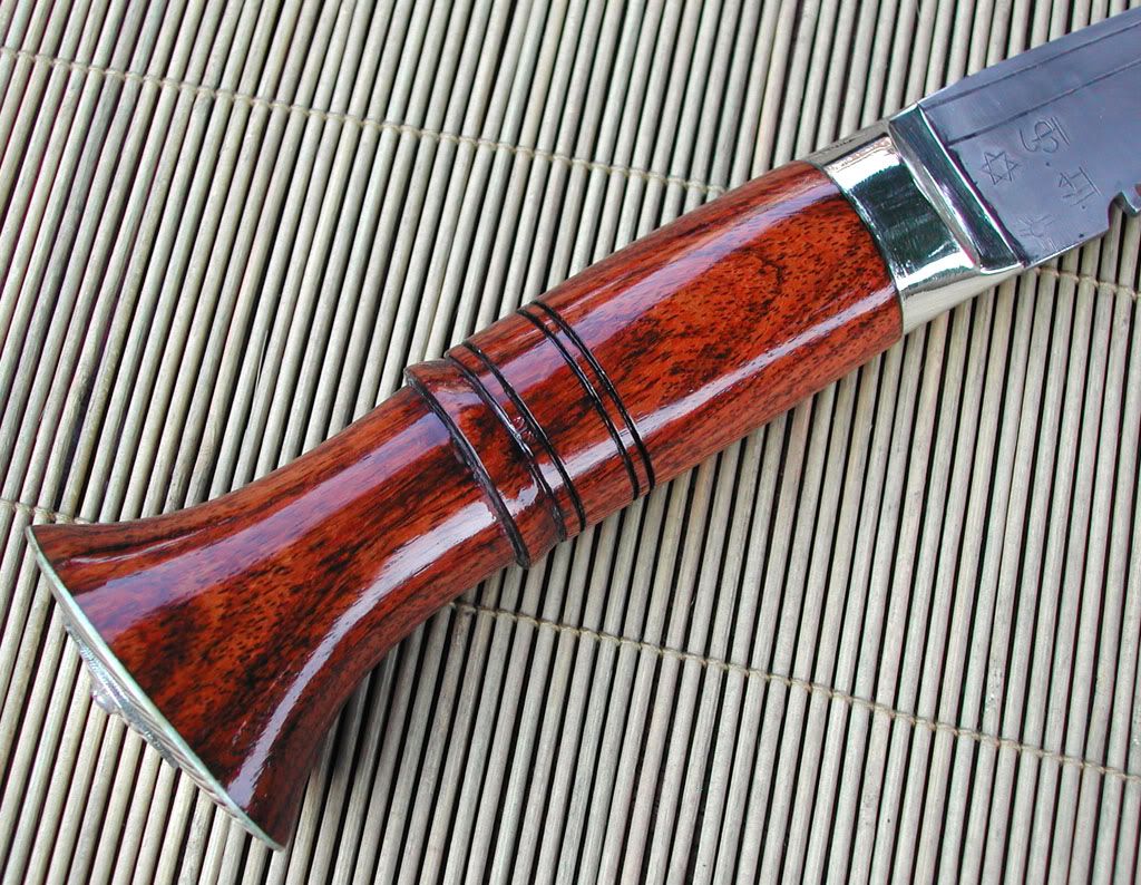

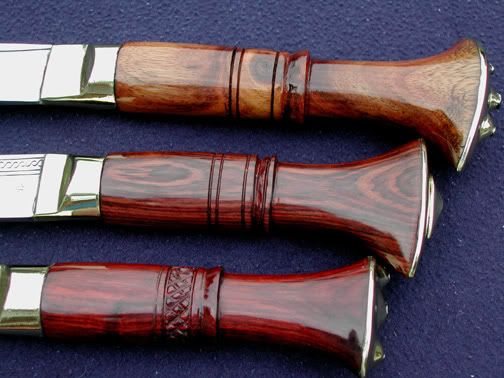

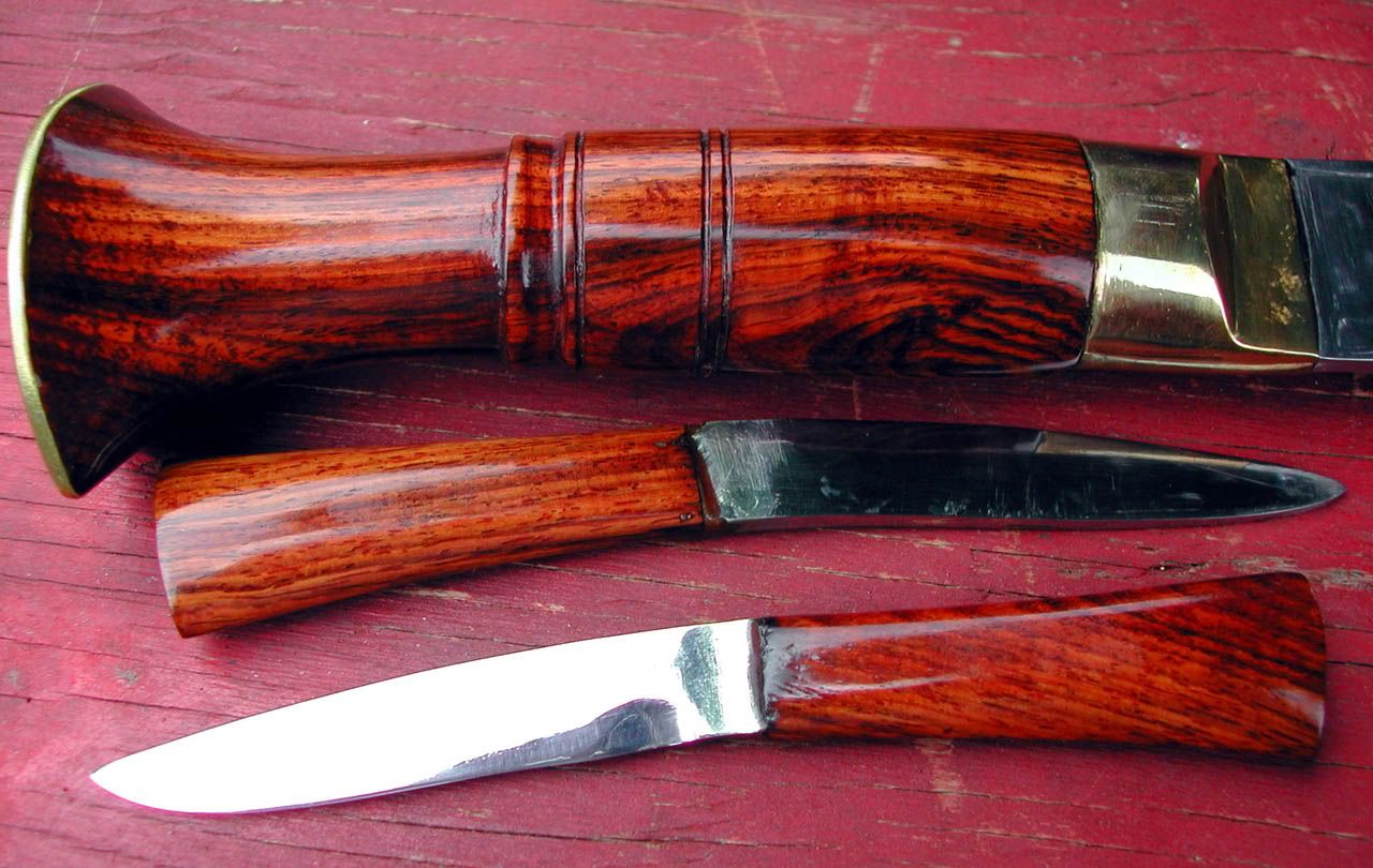

I've been known to refinish a few.
Steve
Steve, those are some great looking refinish jobs! I like those deep reddish grains. :thumbup:
