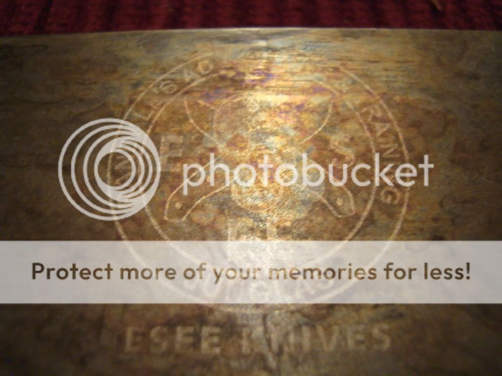

Not fantabulous, but this is my first and only patina. I stuck the Sodbuster blade in an apple for a few hours. You can see where a seed was bisected.

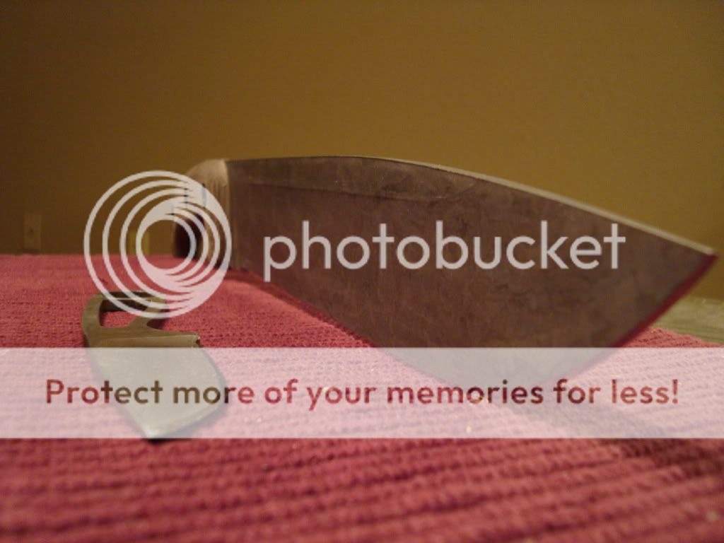

Here is my old edc Gayle Bradley. I put some tape over the edge and soaked it in vinager. I was only going to leave it in for a little while but I got busy at work and forgot about it. 5hrs later the vinager soaked through the tape and made this messy looking design.
After quite a bit of use the patina did even out and looked pretty nice. The knife resides with a forum friend now.

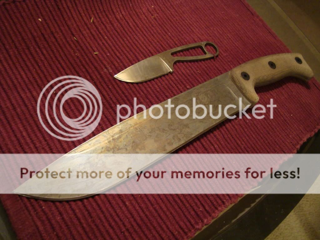

I stripped this Dogfather, and wrapped it with a paper towel soaked in apple cider vinegar.

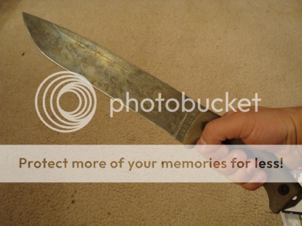

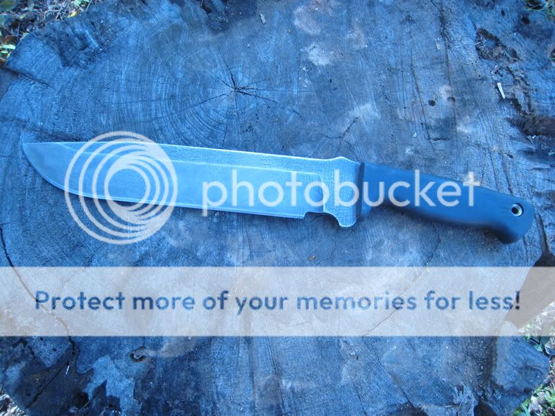

An RC-4 that I did.
Note - On this knife the coating has to be removed first.
Not the best pics but you can hopefully get the idea.
This was achieved by...
1) applying a liberal amount of mustard on the blade
2) wiping off the majority of mustard with angled sweeping strokes with finger
3) wrapping the blade in an apple vinegar paper towel.
4) leave wrapped 45 minutes, then rinse off...may have to scrub a little
