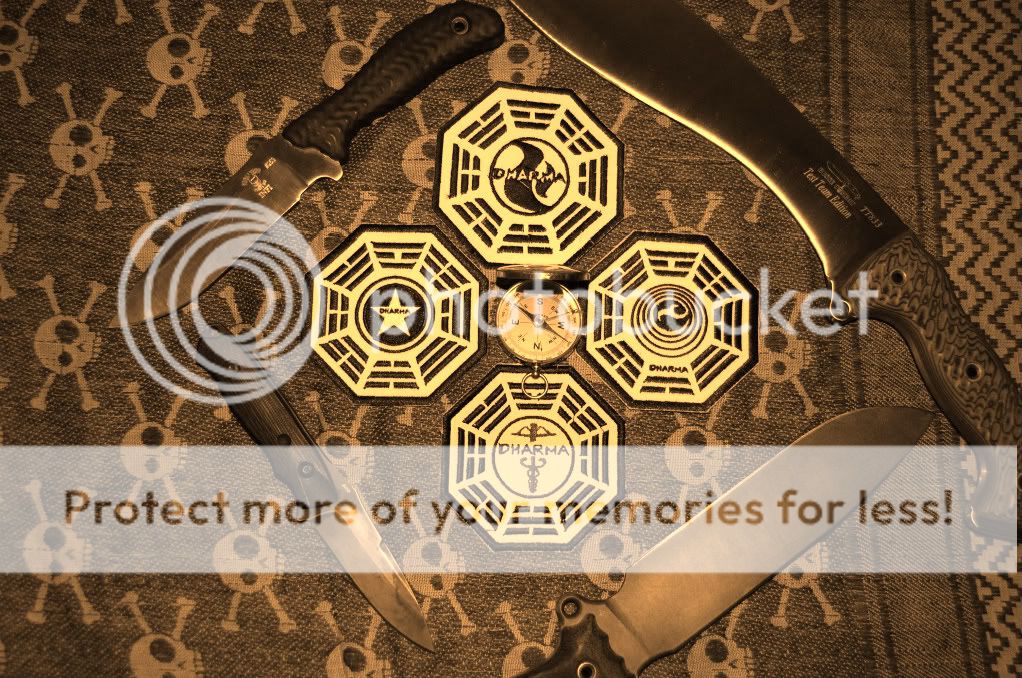

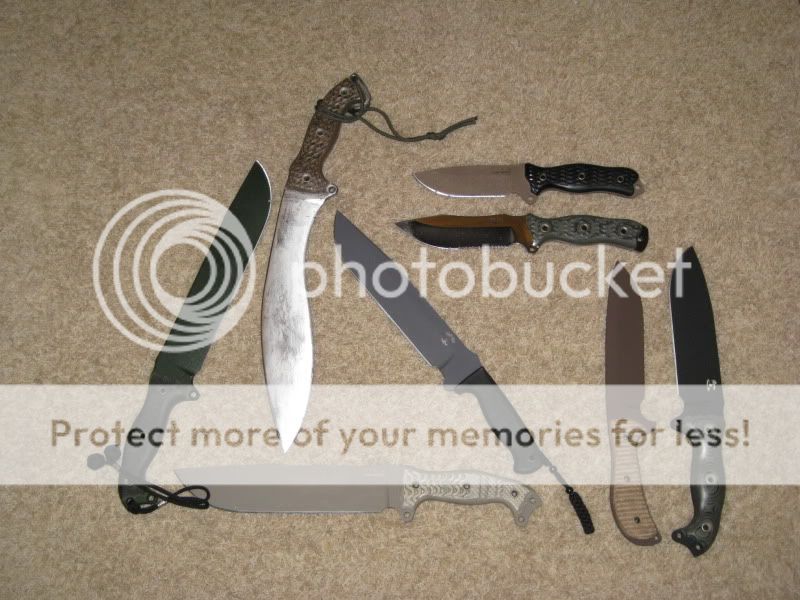

Alright guys, I caved and I'm currently trading for a test team zilla. I don't want to wait for a cg release, I want it now.
Lets see any of your zilla pics, in the wild, on your table. Any pics of the black/tan handled ones would be cool as well as that's the one I'm hopefully getting.
