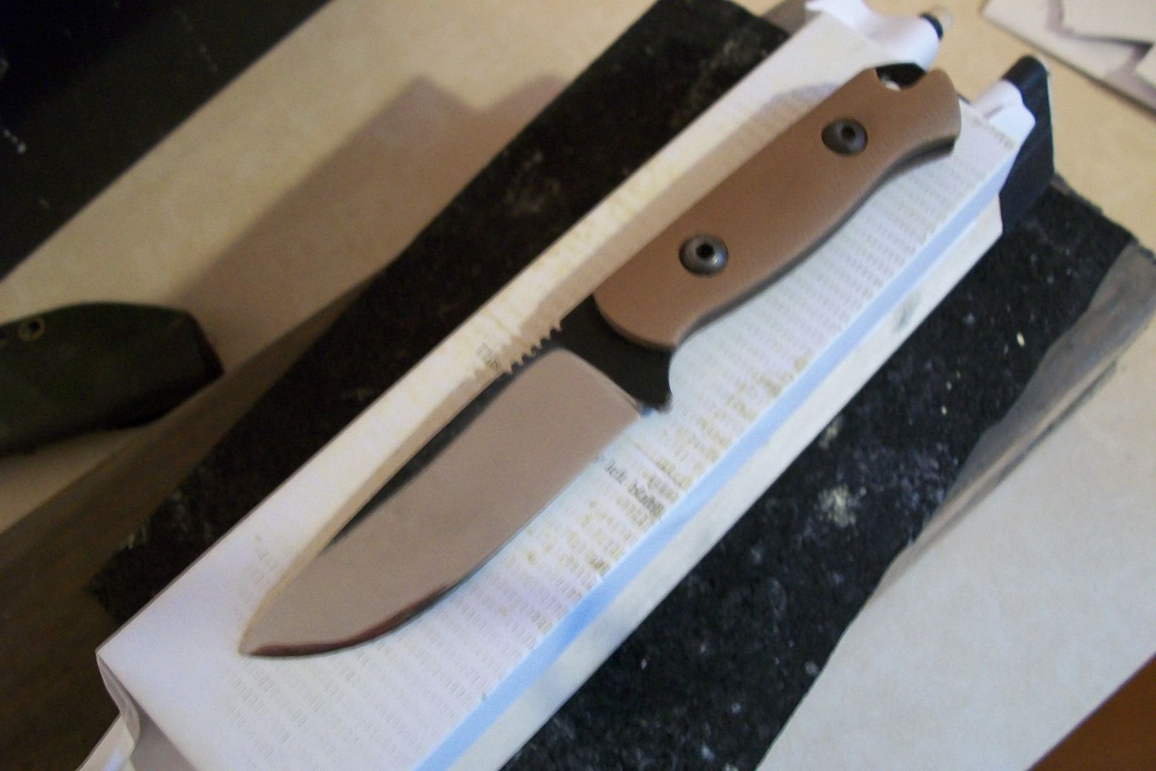

Here's my trusty Bark River. Most of the time I use a Washboard with wet/dry, but the purists might not think that the same as a stone - though side by side it is very much in a range with my Nortons anyway. I still find these full convex and scandi do better with a softer stone than harder surfaces like diamond plates, though for this sort of work and on lower RC steels have had good luck dosing my diamond plates with a pinch of appropriate SiC dust and a few drops of water.
Used my Nortons with some extra mud, then reclaimed some to strop it up on WB. Resting on the 8k you can see some of the hatching around the curves. With careful work even this can be eliminated, or can be polished off on a hard strop etc (or ignored as it doesn't effect function one bit). Still had a bit of haze when finished. Normally I don't sweat the cosmetics much when using a stone on my convex, generally it transitions to a brighter finish over time anyway as it gets touched up. Was also in a hurry when I sharpened this - apologies for the poor pics.
Edit to add: I work the entire surface every time, even if its just a touch up on a hard strop - especially if its a touchup on a hard strop. I always beat on it extra good just behind the cutting edge - maintaining the apex nice and lean should never be a fight.

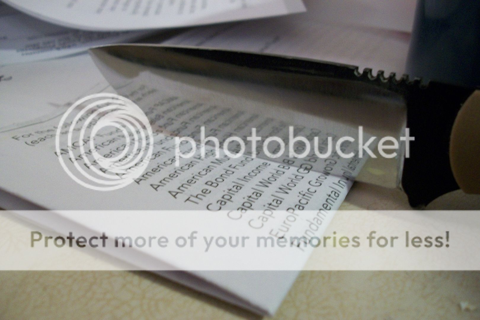

I found this old photo recently, old school Cold Steel Tanto with a shallow stone convex. Japanese natural stone around 10k, worked surprisingly well on the stainless steel.

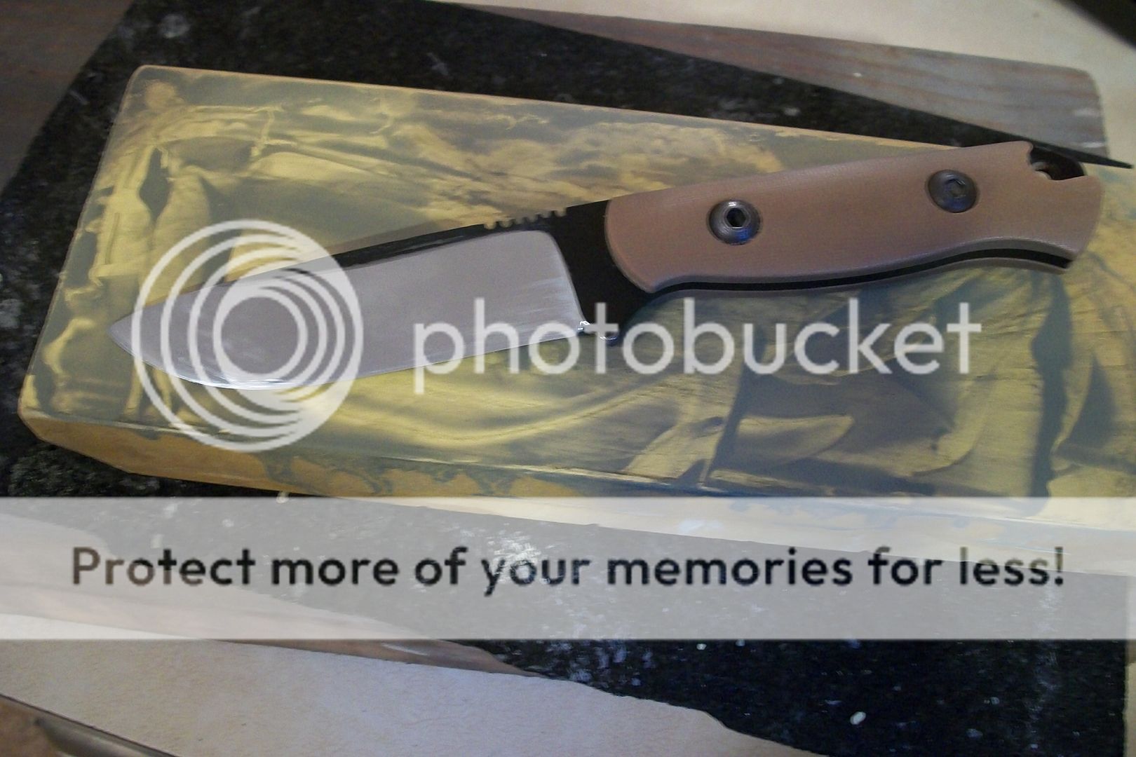

BK2, finished on Shapton Pro 5k, smoothed with 2000 grit sandpaper, dipped in acid :eek:
