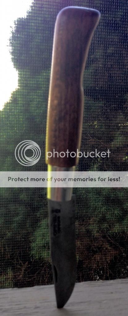

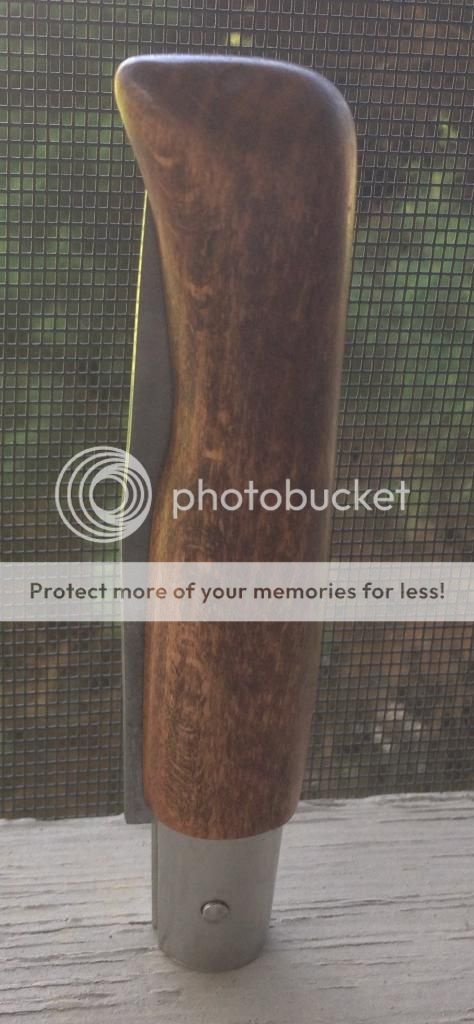

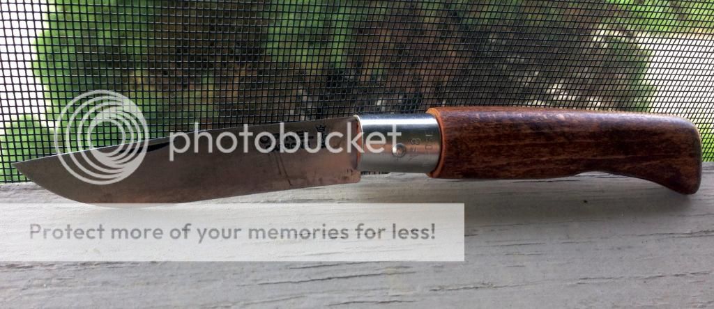

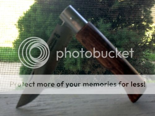

Opinel No. 8 modified by me.
Shaped and finished handle, dropped the tip a little, removed lock ring and adjusted pivot to make a friction folder.
Do you see a knife?
Sorry for the awful pics, but I hate taking pictures and putting them online because its a real pain for me to do and they don't turn out well:grumpy:.
As far as the knife goes, I love it, even though its a No.8, after the handle mods and removal of lock ring, it carries like a No. 7 1/2.
Patina is coming along slowly, as I haven't been using it for much food prep, mostly just opening packages of parts at work and slicing pieces off a block of cheese for dinner.
I really prefer it without the lock ring, and I think I have the tension dialed in just right so its smooth to open but won't do so accidentally in my pocket.

Nice work!:thumbup:
Love the shade of stain, and the depth of it. Did you use a clear coat of something over it?
I've removed the locking ring on one of mine for a trial run a while ago, and not only did I not miss it, but I found the knife actually felt better in the hand without it. Friction folders are a good tool for self discovery while using. Kind of a learning tool in what we really need and don't need. Back to basics, you could say.

Yes, I used a coat or two of polyurethane over several coats of stain. It is the standard beech wood and is rather harder to stain compared to other woods.
I also did a No.7 the same way, I think its the prettier of the two and the handle definitely looks better than this one, but this is what keeps going in my pocket because its a little rougher around the edges so I don't mind carrying and using the heck out of it.

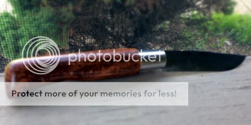

The last Opinel I did, I didn't use any stain either. Just took it down, made a deeper curve in the belly so it can be pinched open, and when smoothed down to 500 paper and 0000 steel wool, I just did a couple thin coats of the Minwax clear poly. I've done so many with a deeper hue, I was just in the mood for a lighter more natural wood color. The beach is hard to get the stain in deep. The locking ring was removed post photo session. It's become my 'beater' knife.
That's I'd almost exactly how hers looks. I didn't think I would like it at first, but she insisted she didn't want any stain. I think it looks quite good like that now.
