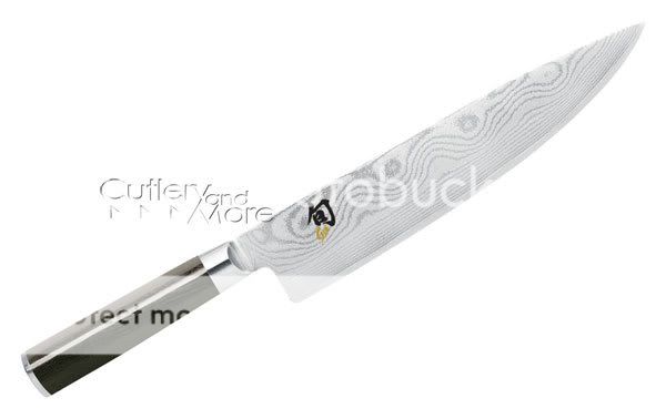

I'm a Chef and I just got a Kershaw Shun 10' Chefs knife from NewGraham knives. First, New Graham Had it here in 2 days somehow even though I paid for ups 3-day!! How that works I don't know. New Graham Rocks!!! and they sent Bandaids, wich is vey good because this Shun knife is the SHARPEST thing I have ever toutched. including strait razors and scalples. Sharper then anything, knives everything. I can't believe how sharp it is. You can't really do an arm hair test because if it touches your skin it takes it. I took a peice of my wifes hair by one end and laid it across and it cut it in half!!! Lets just see how it holds up in the busy ass hectic kitchen getting thrown and dropped and everything else that goes with that, but the main reason I bought it was because it's VG-10, and I know VG-10. It's Damn tough. I didn't want to spend alot of money on a german made knife with 0.435768, or whatever they call it, when I have no idea what it is. I got a set of Forschners and they where fairly cheap and they are pretty tough, but I wanted to spend alittle more for one Great knife that will last me through the years.
Cool! Please do post a follow-up on edge retention and how it holds up to real abuse and so on. I love the look and feel of the Shun but given that my partner is wont to leave knives in a sink of water etc I figured I had better stick with something like the all-steel Henckels--no wood or resin to warp etc.
These aren't bang-around knives. They're lasers with damascene cladding.
Your reward for using the cutting board and hand-washing/hand-drying is you can make more precise cuts and cut much faster than when having to muscle through food. I've got an 8" Shun Elite chefs knife and only stop to use a paring knife so I don't get thrown in an asylum.
