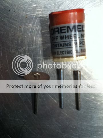

One thing to be aware of is the cut off disc mandrels need to have backward threads for the flex shaft. I forget occasionally and try to run a Dremel cut off disc in the flex shaft and all I achieve is cutting the screw in the mandrel in two.
Does any one have a source for Dremel size cut off disc mandrels with reverse threads ?

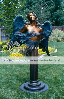

The end result looked like this.
That was a very early one before my time.
We didn't do this one but similar work. Heck I didn't even own a camera way back then.

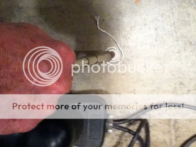

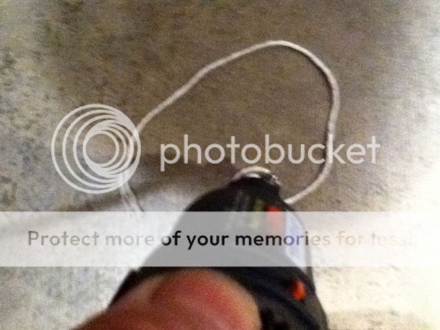

The flexible shafts turn the same direction as a Dremel, unless they have a reverse switch.
Mr. DeShivs,
You are correct sir. Of course.
I wound up having to prove it to myself.
Doh . . . Ha, ha, ha
I wonder why it eats abrasive wheel mandrels ? More power and lower speed I guess. As I said I run hot and cold on the flex shaft because of this “problem”. I NEVER harm the same mandrels on the Dremels. I probably have a few more of these mandrels sans screw around . I tell myself that I will measure the thread and buy some screws to fix the mandrels but have not done it yet.
I wonder why I got the perception the swarf coming off the bit is going down rather than up into my face. I must hold it different and not even realize.

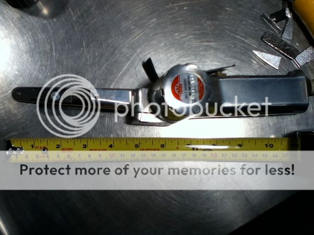

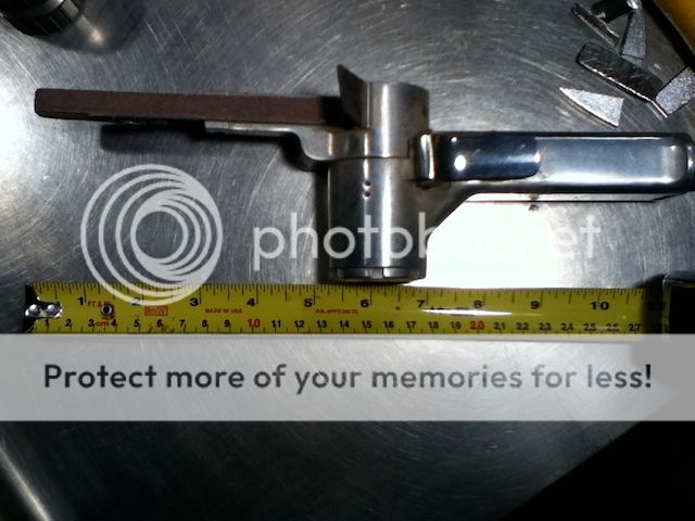

Speaking of air tools; here’s one for you all . . . a mini belt sander.
