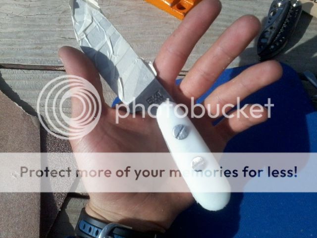

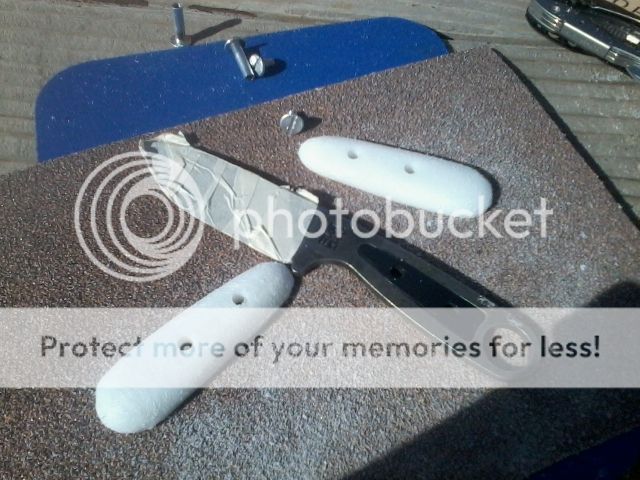

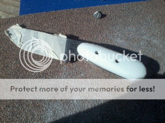

Anyway, I cut the board up with a saw, whittled them down to shape, hand sanded them with 36 and 100 grit sandpaper, made liners from kydex scraps I found lying around.
I started this project this morning, and am left with this so far:
I still need to countersink the screws, but before I do that, I wanted to ask if it would be wise to sand the screws down to match the profile of the scales better. I wouldn't do it much (or not even touch the side with the screw). One side is completely flat, and the other has a flat-head screw.
While I figure out that dilemma, I will need to glue the liners on the scales themselves and decide as to whether or not I should stipple these bad boys.
(I have also evened them out after I took these pics)
What do you guys think so far?
Looks good. I would just counter sink the screws and leave it at that.

Looks good man, I am digging the white scales. I would countersink the screws then see if you want to level off the heads of them. If you countersink them enough you might not have to mess with the actual screws. I am not a big fan of stippling so i say polish them up, that is just my 2 cents though. Great job so far. Be sure to keep posting pictures.
Yeah just counter sink em, and maybe see if you can use ryt die on em to get em a cool color(not sure if the die will work on that material though)
If I could make the screws look smaller, these would definitely look a lot better, IMO. I'll countersink 'em as soon as I find the appropriately sized bit.

When I made the scales for my 14 I just used 2 machine screws and a coupling nut. You can see how I did mine in my thread.
This is what they look like, Not sure if its quite what you meant but maybe in the right direction.

It is very fun IMO and the $4 I spent total on this project so far is wayyy worth it! I still want a set of the zytel for that factory perfection; mine are thicker, but they aren't as elegant! And thank you for the compliment sir! When I finish them up and I use my actual camera, they will look a ton better.
Where did ya find that coupling nut? That may be exactly what I need to make her look all pretty!!!
I loved that thread, BTW. The only reason I never did wood is because I wanted to do something synthetic like this.
Thanks man! I picked them up at the local ACE hardware, far better selection on fasteners compared to lowes or H depot. My only gripe is that they are aluminum so they are a little soft. But its nice because as long as you get the right thread pattern on the screw you can use what ever style head you fancy. I really like the look of the white synthetic. I might give some white scales a try on my 16 that should be here tomorrow!
