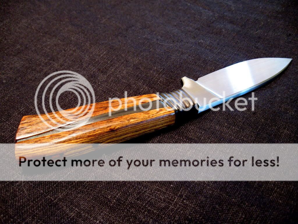

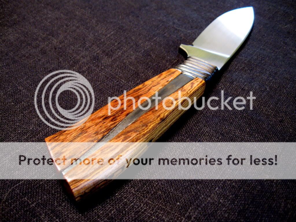

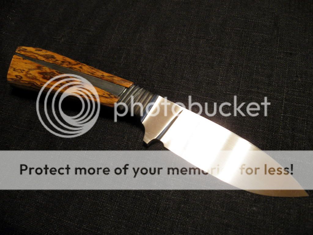

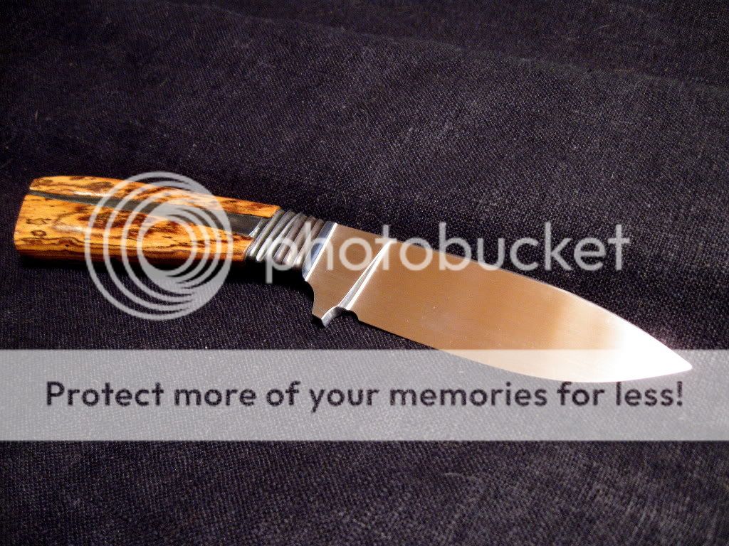

Hey all you crazy knifemakers!
Here is the latest project. I have been chipping away at this one for a while. It was forged out of 1" round 5160 with a sideways tapered tang. The slabs are Bocote and are slightly oversized and radiused to meet the tang and are attached with 2 hidden Micarta pins and one visible pin (just 'cause I can).
This will be on display at the upcoming NCCA in Mystic, CT on May 1st and 2nd. It should be a busy, exciting show. Please stop by and say hello!
Thanks for looking,
Nick
