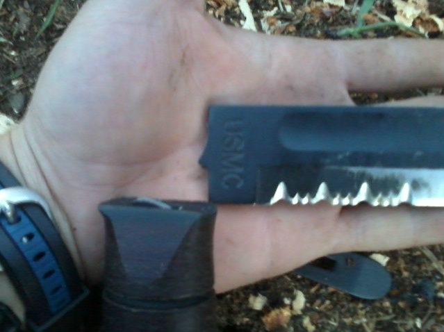

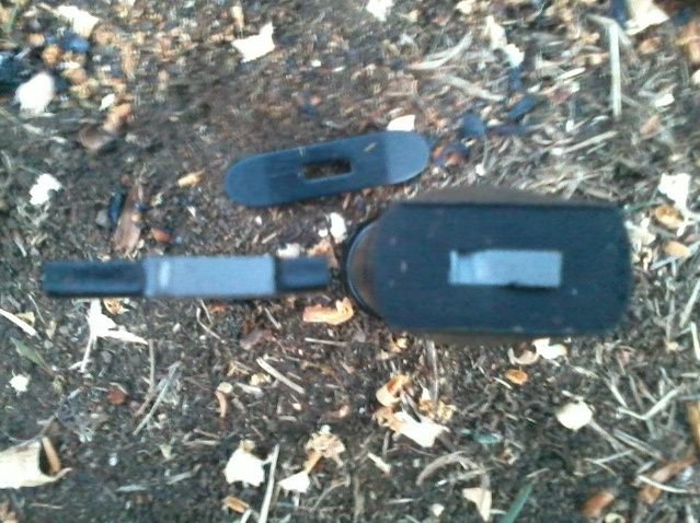

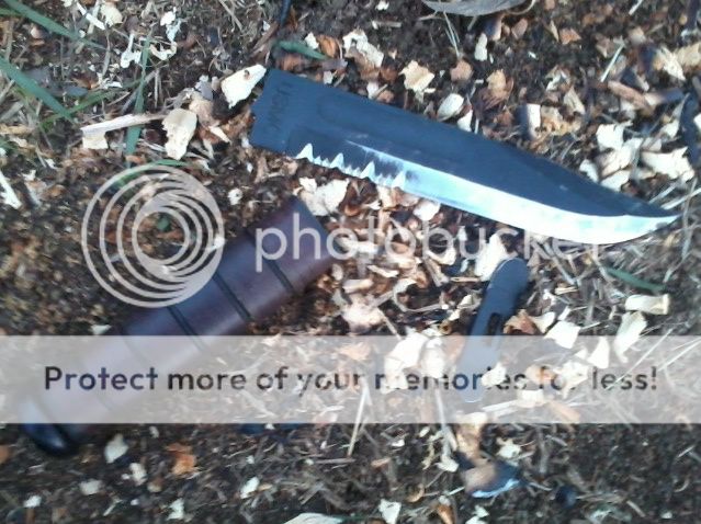

Yesterday, my buddy and I decided to try to have an over-nighter trip not too far from homes. As those of you here in CO know, the sudden snowfall made things interesting to say the least. I brought along my trusty Ka-Bar USMC that had been begging me for an outing for some time since my introduction to Beckers.
As the temp dropped, we got colder, and we needed to get the fire going. Because of this, I batoned 4-5" logs to make some kindling and after a couple logs, I heard 'PING!'. My baby snapped at the guard...I almost cried.
I do not blame Ka-bar, the knife or anybody but myself for this tragedy; she has been through hell and back with me for 4.5 years in the forests up here...I guess it was her time...
Should I contact Ka-Bar about this tragedy? I am ashamed at the fact that I broke my knife :(
I am sorry for the crappy cell pics, my camera doesn't want to connect to my damn computer now...what a sh*t day...

Sad to hear it broke on you man :(.
I've seen a few USMC's broken right there actually. Its because of the sharp corner there at the tang, it creates a stress riser, and after enough abuse, it lets go. I think Moose has broken 3 of them this way in his long and illustrious career.
But now that you know about Beckers, replace the USMC for the sake of having an old friend back, but the BK7 is built to take the kind of work you're used to, and should do just fine :D.

Let this be proof for naysayers who believe that the Ka-Bar rat tang does not have limits. This is just one of many examples. There are quite a few folks here who believe the Ka-Bar fighter is indestructible, mostly because it served with distinction in U.S. military history. That doesn't make it a bushcrafting knife. It is a fighting knife. In an emergency, you can use it for bushcrafting tasks, but this happens often enough (the blade breaking off at the handle). Combined with the weak tip, blade coating and full guard, this should turn most people off to this knife as a bushcrafting knife.
Now then, as a fighting knife, it's still a great choice, but it would be my last choice for bushcrafting. For those who say this is "normal..." It's normal only for a knife with a rat-tail tang. It is absolutely *not* normal for a full-tang knife of reasonable quality. Knives have jobs, just like people. The Ka-Bar fighter's job is fighting. For bushcrafting, I'd get a proper bushcrafting knife.

they dont round off the tang at the blade tang junction, my kabar heavy bowie did that when i pressed too hard holding the knife sheathed against the wall going in a door the torque snapped it with virtually no pressure and i didnt know till i unsheathed a handle only knife.
ive gone forged only ever since and haventlooked back.

When I got orders for Viet Nam I knew I needed a real knife since my Dad, a bazookaman in WWII, had always told me, "A bayonet has only one purpose, and it isn't even very good at that!" I went to the sporting goods department of my local discount department store (no Internet in those days!) and saw a knife in the display case that looked like the one's I'd seen Marines use in the old movies -- except it was shiny. Still had the stacked leather grips, though. Since tactical black is all the rage these days I don't even see that model available anymore -- think: #1217 but with a shiny, plated blade. I asked the not-too-bright sales girl to see it, then wanted it. It had no slip attached and I asked her how much it was. She looked around the case and in the cabinets underneath, then came up and said, "I can't find the box or the sheath, so how does $2.00 sound?" Sold!
I roughed up the plating and put gun bluing on it, made a leather sheath, and carried that sucker for my full tour. Weeks before returning home I was playing mumbletypeg on the wooden floor of the hootch and heard that sickening "ping!" and the parts went flying. Damn! I'd hoped to bring that home and keep it with me forever. Certainly couldn't blame THAT on cold weather! :D

It's not just the size of the tang. It's the square shoulders as noted and, unless they have changed, heat-treating the tang to the same hardness as the blade. Those are two weaknesses that result from economical manufacturing practices -- to be polite.
Rat-tail tang knives have served in the woods with distinction for centuries. The first Europeans here doubtless carried them. Battle swords to this day do not have full tangs. So is telling the Scandinavians and Finns, in effect, that they don't know what they are doing when they make THE traditional bushcraft knife just a tad presumptuous?
