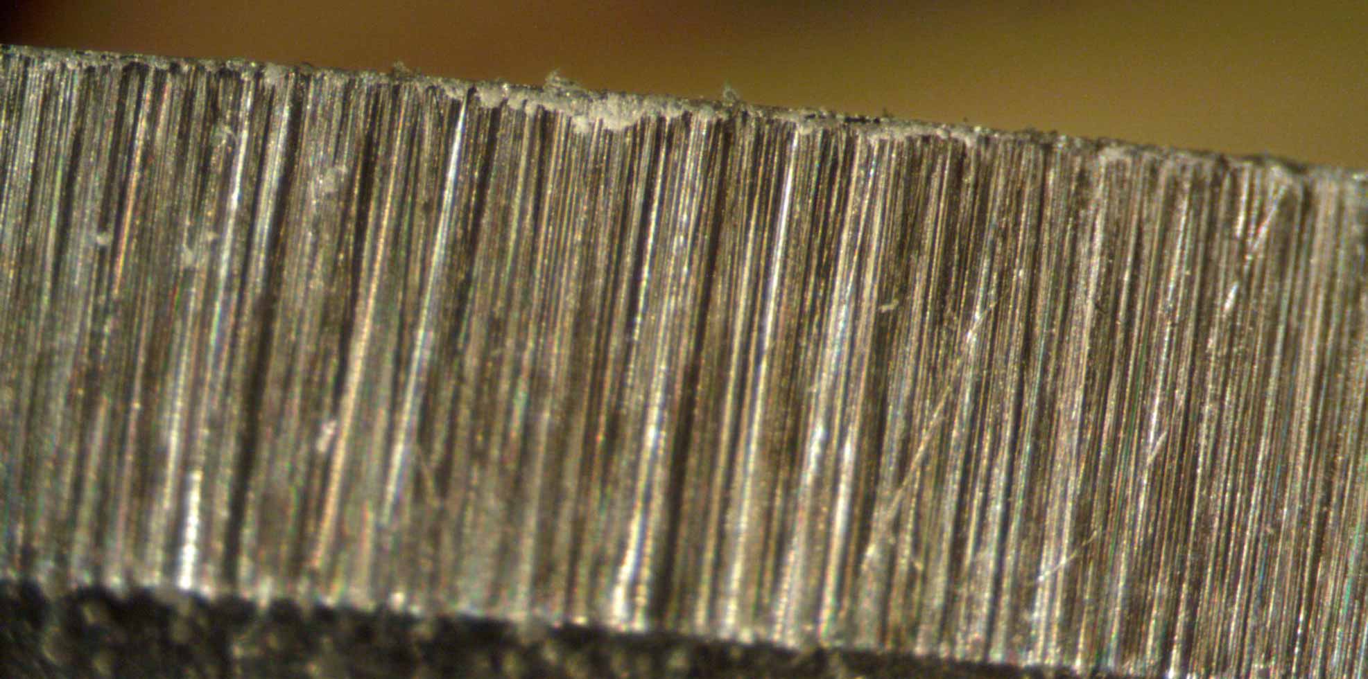

Maxamet is a very interesting steel to sharpen. I have taken big chunks out of the apex with a leather strop. The problem was I used a cream which created more drag on the steel causing the point loading on the apex, which like ceramic it doesn't like. Now I use water as the carrier to load my leather strops.

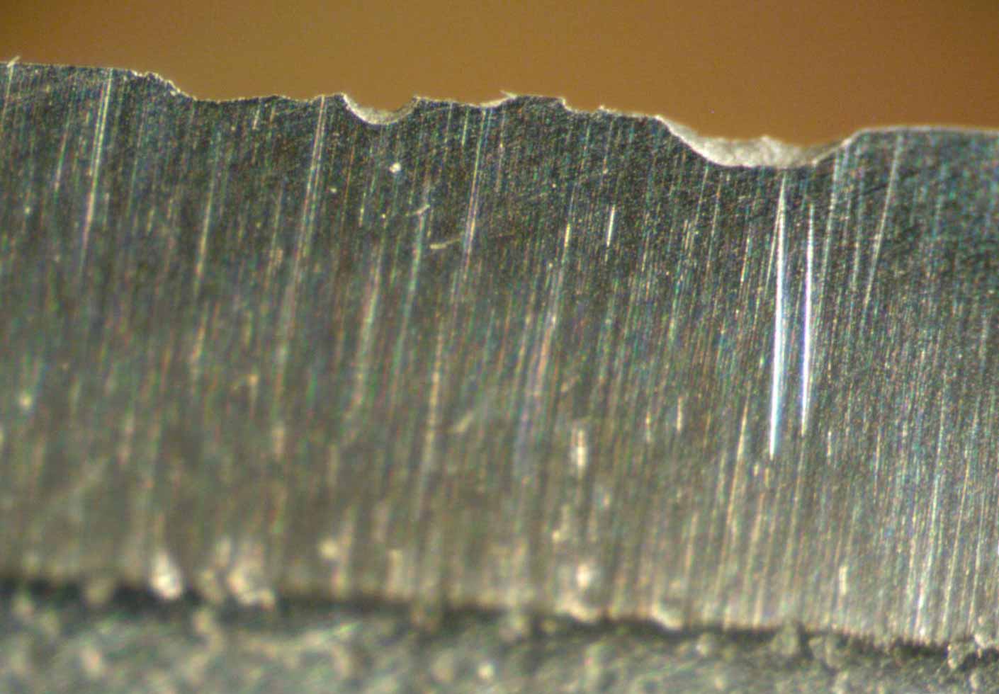

Here is the same blade but after sharpening with a 160 micron diamond stone. As you can see the apex just crumbles away, it will only get so keen with such a coarse stone. The bevel width on both photos is around .05" for scale.
As you can see from the photos it isn't the carbides tearing out causing the problems, it's the funky steel. Still, it's my favorite steel for knife blades.
Yes you need diamonds, or maybe CBN, but since I have a horse in this race I can't answer your question. But whatever you get use light pressure on the stones and be aware of point loading with this steel when sharpening.
