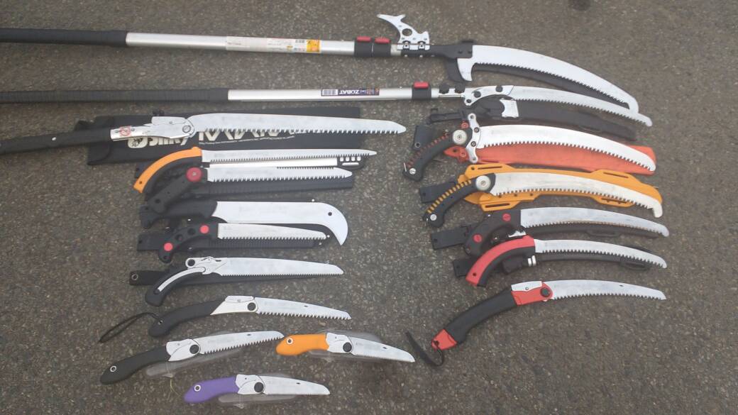

that's my personal collection I have the katana boy and Sugowaza in my collection and I absolutely LOVE the Sugowaza, I'm an arborist and I use my Sugowaza daily! I put it on my belt when I arrive on job site and only take it off at lunch break (sometimes) and at end of day on my way home. It's the best silky period!
