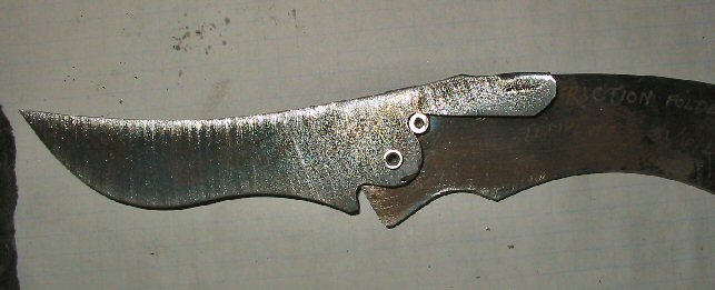

It seems to me that friction folders are becoming a lot more popular here. I've never heard of them until browsing these forums. Anyway, I was just curious, but how do the folders stay open? Is it supposed to be the person's hand grip that holds the blade open? I suppose that makes sense since the material being cut pushes against the blade. What's the "friction" part?
Usually the pivots are a little tighter than you find on a standard folder. And yes, the extended tang on the blade makes it so your grip holds the blade open. :)
Heres a pic I found that accurately describes how it stays open - would appear some grip on the 'lever' would be necessary.
(pic courtesy of deviant11 - British blades forum)
Friction folders generally have an extended tang that part of the hand, sometimes just ones thumb, covers to prevent the blade from closing.
If not for that, friction is the only thing preventing movement of the blade.
