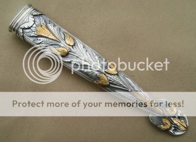

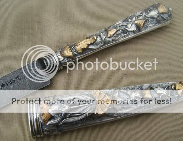

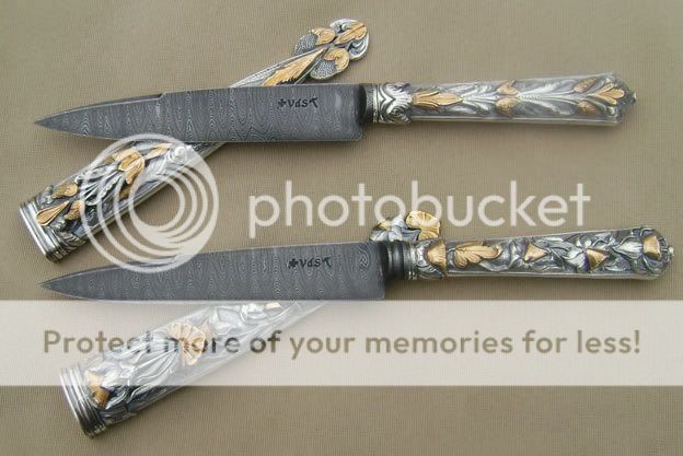

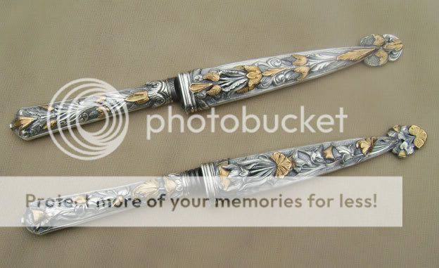

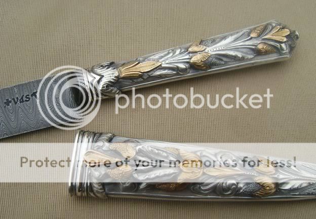

These are Argentinian criollo knives
This work is done by Javier and Marcial (Blade), Handle and sheath by David Saco (silversmith)
Blade lenght 12 cm, 15N20 and W1.
I hope you like it as much as I like it. ;)
Horacio

Beautiful workmanship. I really like seeing knives that are reflective of different cultures.
Roger

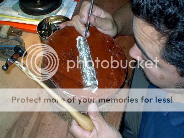

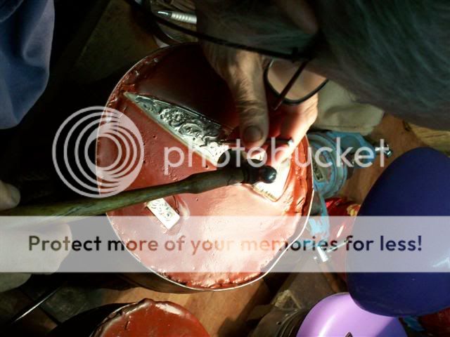

Can you tell me, are the handles and sheaths carved or cast and then finished?
It looks like they're repousse' , embossed and chased. I could be wrong though.

Really nice workmanship. Whether cast or not, someone had to do some mighty nice carving. Always nice, as mentioned above, to see cultural diversity in knives, as in all other areas of life.
The handle and the sheath are made with chisel as shown in the picture.
Criollo knives (in this case is a "verijero" because it has a 12cm blade) are the kind of knife used by men in the country. This is a luxury piece because it's been done with Gold and silver, but I can ensure that the blade is of the best quality and fit for any job.
Horacio
I guess some people don't realize that knives of this basic design have seen hard use in the field for centuries. You probably wouldn't choose to take such a magnificently embellished version out for work, but I don't doubt that you could rely on such a piece if you did.
Roger
The reason why the Gaucho and Criollo knives were such great field tools is exactly the basic and universal design they had. Mostly because the south american cowboy - the Gaucho - could not afford more than one knife so this one knife he had should perform well in many different tasks, such as fighting, hunting, cooking, and all work you need to perform on a farm.
If you need THAT much versatility on a knife, you want a very basic design
The pattern is actually an evolution of the French trend knife or the Mediterranean dirk. In fact many of such knives were imported from Europe.
The innovation was the shape of the choil that prevented the fingers to slip to the edge keeping the users hand safe, pretty much what Jim Bowie did by adding a guard to a similar knife.
