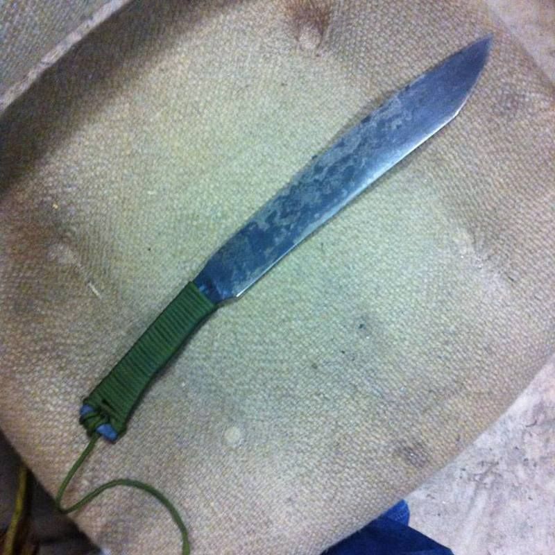

Here's what caught his attention. Still with oil baked on from the heat treatment, with a loose paracord wrap temporarily on it to protect my hand from the rough edges of the tang while doing a bit of test cutting. Steel is 80CrV2, blade is a bit under 12" long.

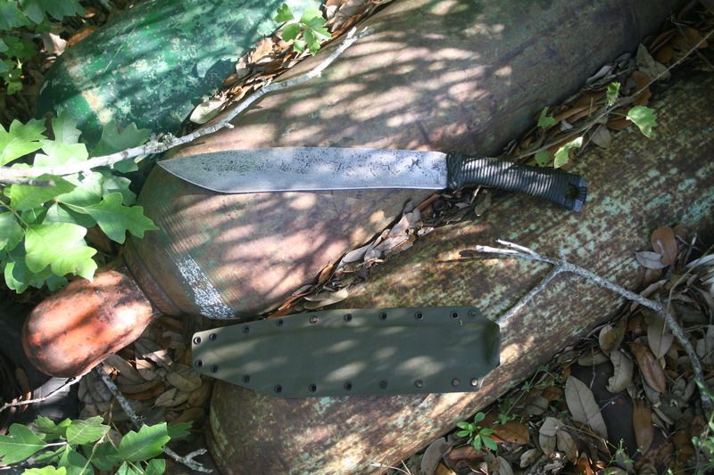

He liked the look of the temporary wrap, so I laid a foundation of neoprene to bulk up the handle and did a single layer of paracord with a two-strand Turk's head knot before applying the marine epoxy. The end of the wrap leaving the corners of the tang exposed is something I haven't tried before, but definitely will be doing again! I did keep it (and myself) away from the poison ivy on the edge of the photo.

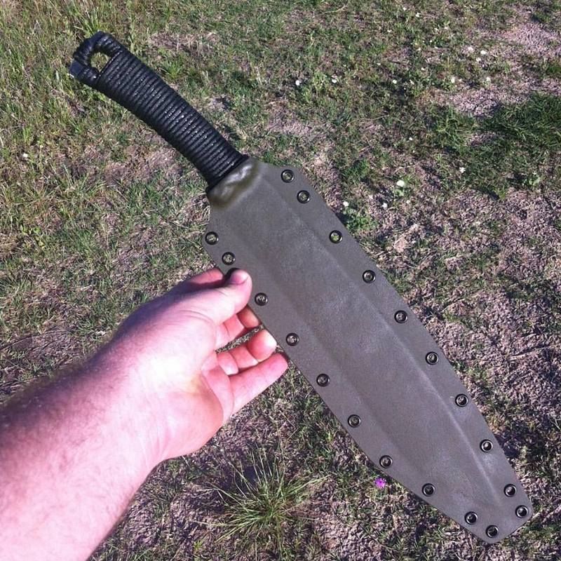

And a basic OD Kydex sheath to round out the package.
It got to him a day ahead of when it was slated to. He was very happy with the heft, balance, and handling.
