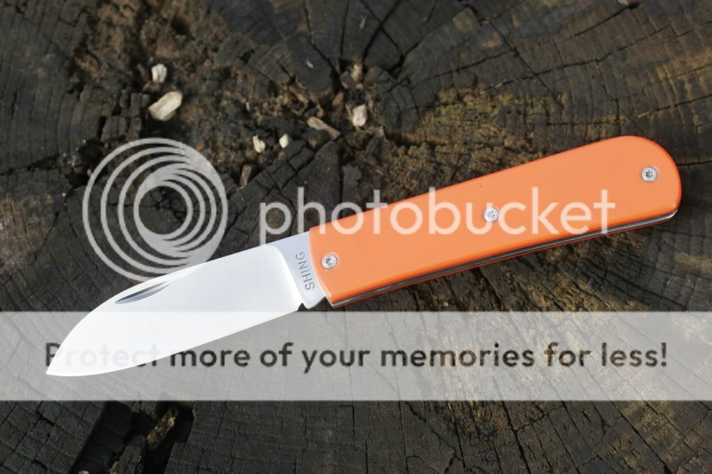

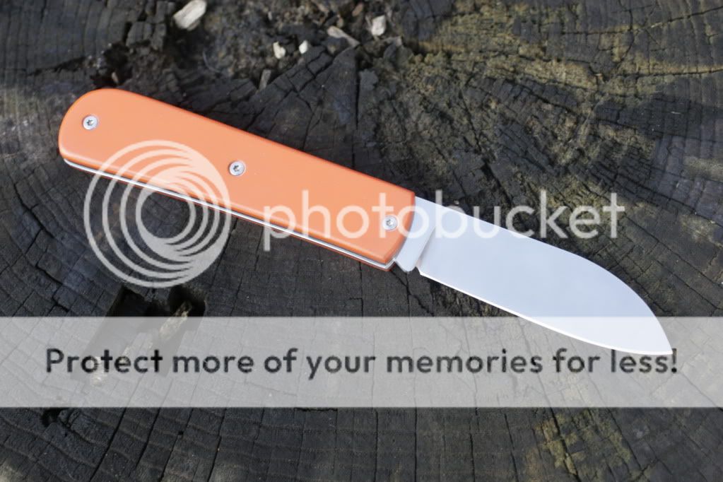

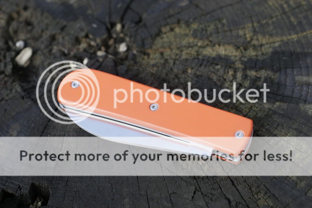

Made this a few weeks ago. Its a hybrid construction with rivetted pivot and screw on scales. 440C blade, stainless liners, G10 scales. Blade is about 3 inches long.
I like the screws and that they are subsurface, with the angle acting as a chamfer. Very finished look.
