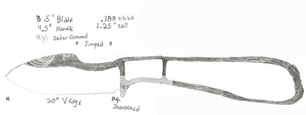

So, I missed the grind-in at Ethan's but I still wanted to do it, so I decided (with some help from J. Terrio, T. Hunt, and J. Nowka) to go ahead and do it myself! So first things first the design I decided on is a "harpoon point" I'm calling it, I don't know if that is the actual name or not, but it's what I'm calling it.
This was the initial design:
After some rework it became this:
then I took it "off-line" and into some cardboard:

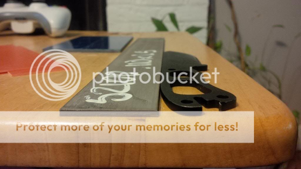

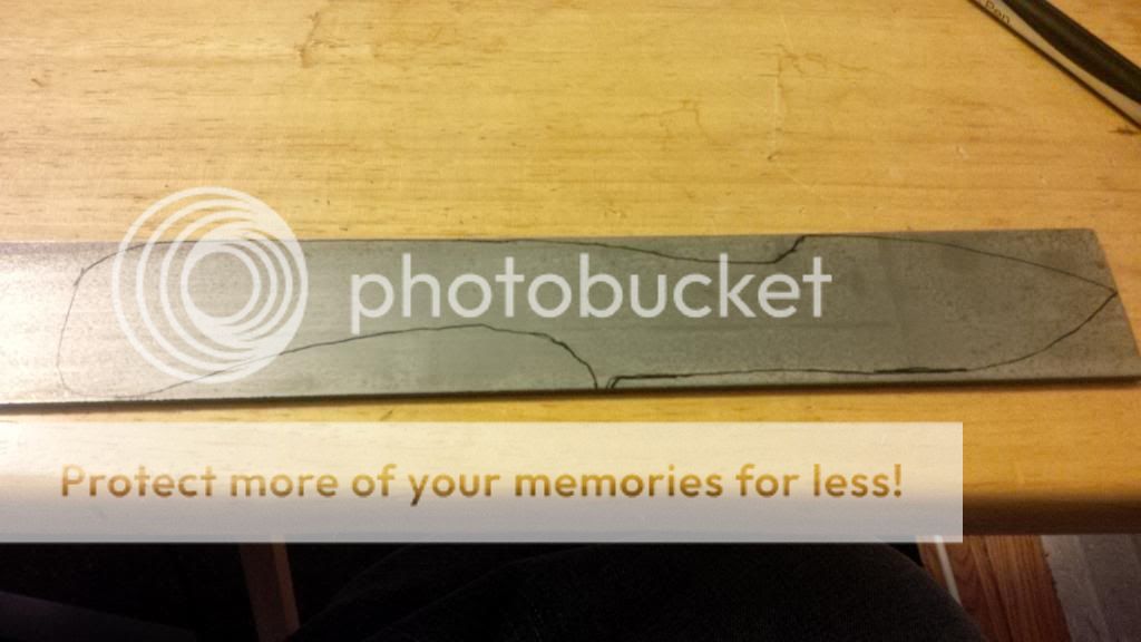

I realized one it was a good size but it doesn't cut worth puu-duu! So, next logical step was to order some steel! Ok, next logical step is take one back and look and go "Really dude?! You have ZERO technical skill and you're going to make a knife!!! BY HAND?!" And it was after THAT step that I went onto USAKnifeMakers and looked at the steel they had available and figure out what I wanted. I wanted to try a steel I had no real exposure to and something "fun" I have LOTS of 1095(/CV) and I have A2, D2, yada yada yada... So I decided to get 52100. Also went ahead and got my G10 for my scales (Blue with Orange liners! WHOOT!) Today I got the shipment in:

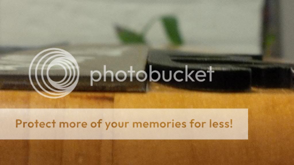

With a BK-11 (cami) for thickness comparison:

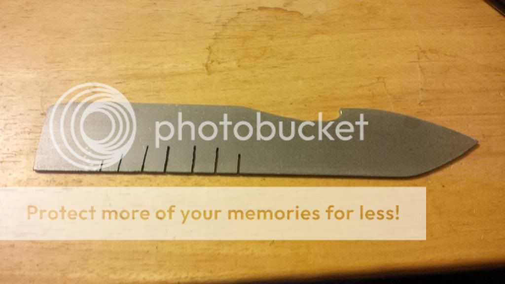

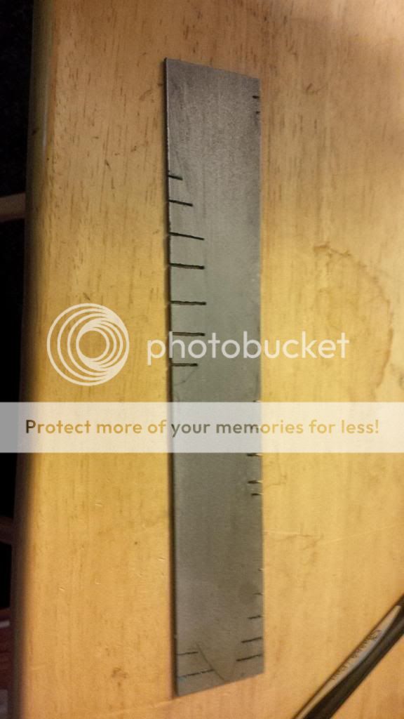

After that was done I remembered another WIP thread that Todd was helping on and had the depth cuts around the blade to make it easier to cut out, so that is what I did too.
And 45 minutes later, lo and behold

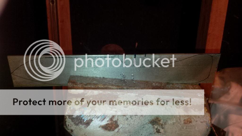

Now papa is going to lay down for a nap so I can't make the noise in the garage which is fine because doing all that by hand with a dolla general hack saw (it was what we had...) really makes your hands TIRED!
So, this is where I'm at now... My Dollar General hacksaw blade went dull, completely dull, it actually was not even viable to cut paper (yes I tried just cause I was curious) so off to the hardware store I went (Home Depot ACK!) So, I bought some new blades, a 10" double cut bastard file (flat) and an 8" single cut bastard file (round) and a calipers (so I can get the median lines for the edge) Got back from the store and got back to work... and now
Ta-DAH!

I recommend ditching the handle cut-outs. That's the kind of feature you do when you have a CNC machine or a huge die blanking press.
Drilling some big holes might be manageable.
crappy hacksaw blades are crappy. Buy a Lenox or something. (they're not supposed to cut paper anyway)
great work so far!

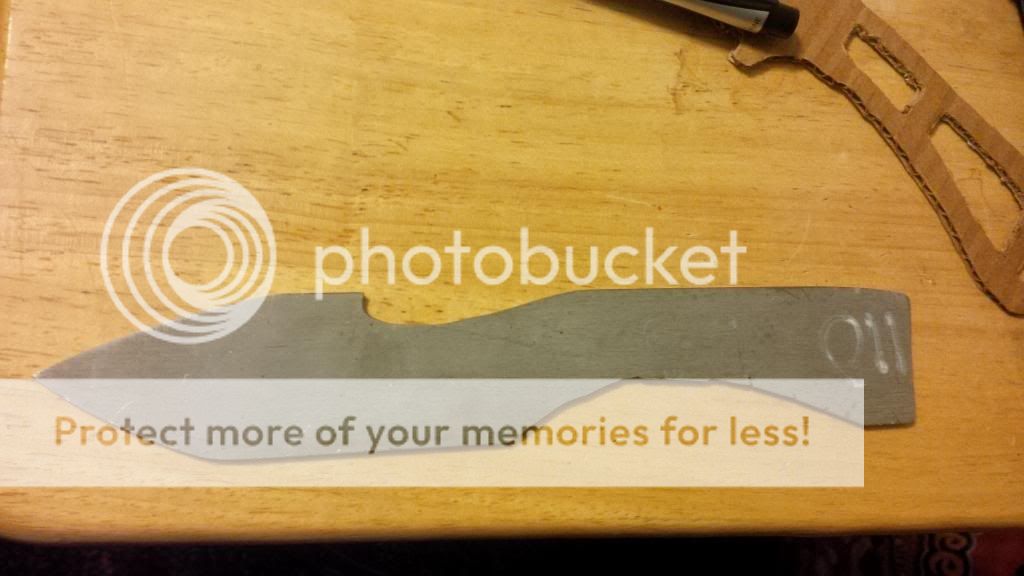

So, I couldn't wait... I ended up back out there this evening and finished the "rough cut out" I actually did end up with Lenox hacksaw blades, and Nilson files (but like a dumb*** I forgot the file card... Thankfully I have a wire brush that kind of works) I still need to get a hold of a belt sander I think to make the clean up REAL easy, which means going to Springfield... (I have one at my brothers house)
Minor update...
Profile is done and cleaned up. Holes for the scales are tapped (can be enlarged if needed... Love having a drill press!) and getting some help on the blade. I don't completely trust myself to keep the edge even and straight.
