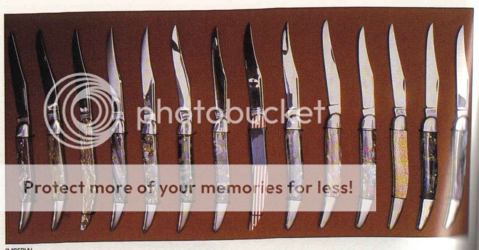

Here is a pic of part of the Mr. Williams collection: Texas toothpicks by Imperial. There are the old, quality, solid handle and bolster type. Beautiful, huh? This has nothing to do with the question above, I just wanted to show these off. I understand Mr. Williams gave many knives to Schrade to become part of their factory collection. Is that where these went, I wonder? Does Smokey now own them? Will they peddle them off piecemeal? Sorry to get us off subject, but I think these are cool.
Phil
ps... my last post this morning, I promise.
Larry... no no, those ain't mine. They were part of Herman's collection that I found in a book. Not to say I wouldn't want to own them..
