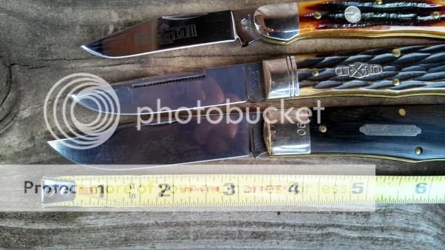

Might look at GEC 73 pattern. Here is mine sitting in between a Queen Copperhead and GEC 42 for size comparison.
