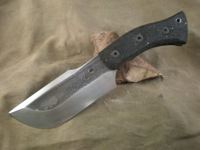

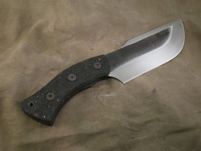

This is a bigger, badder version of a new chopper I recently finished that was dubbed "sinister". I think the name is fitting so it stuck. This one is made from 1/4" 5160, it is 12.5" oal, w/ a 6.5" blade at 2.5" wide. I attached High density stall mat on the handle via 1/4" allen bolts tapped into the tang and a stainless tong tube. This thing is pure utility! Hope you like it. :D

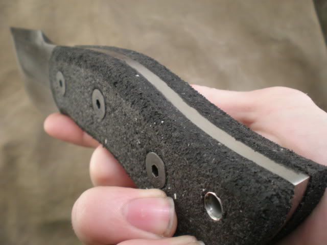

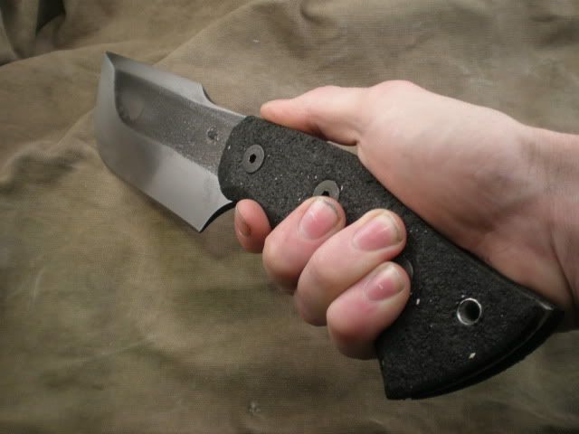

Nice blade! How's the grip and durability of the stall mat? No offense, but it looks difficult to "finish". The lanyard hole isn't perfectly flush, due to the small holes withing the rubber.
I was considering doing my Ontario machete handle with some stall mat. Do you think that flared tubes would work, or is the rubber too soft.
Thanks for any time and info, I've only seen what was at Tractor Supply, and a 4'x6' mat might be a bit big for one knife.
Stall mat definitely won't win any beauty contests, But it is probably the most comfortable handle material ever! I actually recessed the thong tubing on purpose, because the mat is fairly soft I didn't want it to dig into your hand. I did flare the tube as well, you can see it pretty well in the second to last picture. As far as durability goes, I'm assuming since it was designed for horses to walk on it should wear pretty well, I know several other makers that use the stuff on competition knives. but this is my first knife with the stuff. Let me know how much mat you need and I will send you a couple chunks if you are willing to pay for shipping ,I did buy the whole mat! :)
