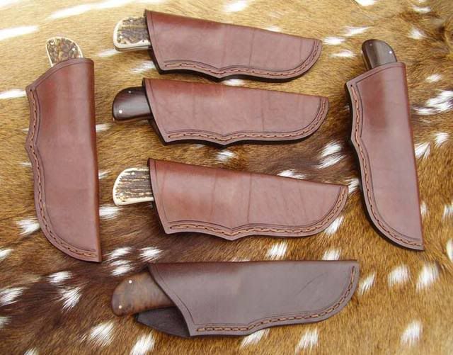

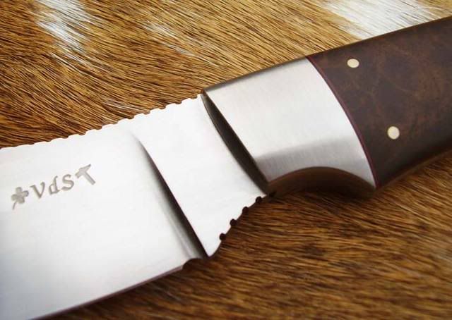

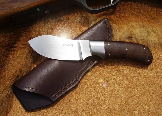

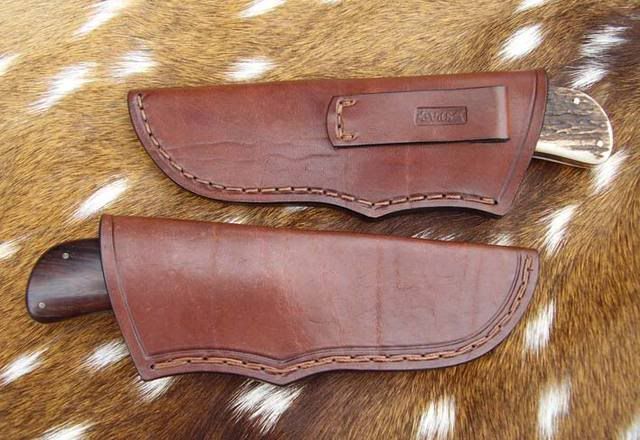

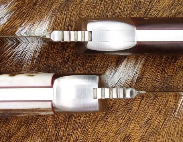

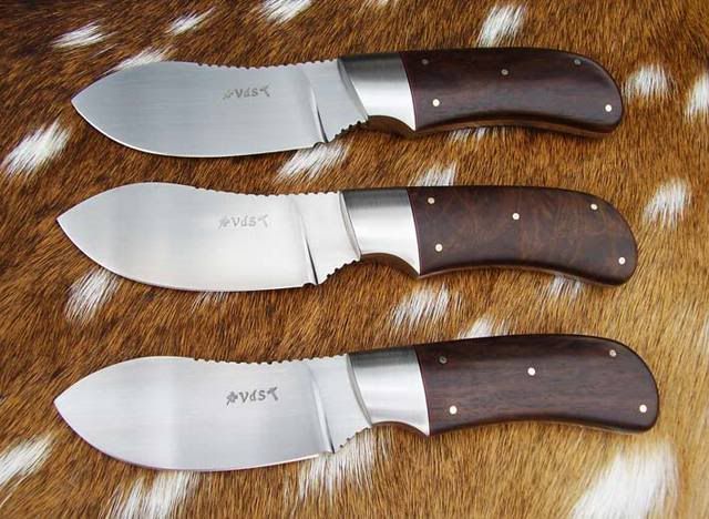

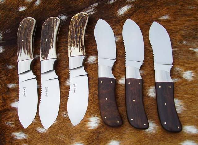

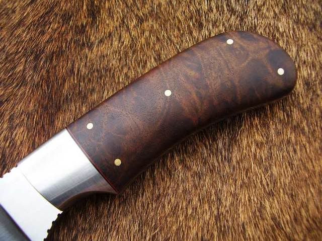

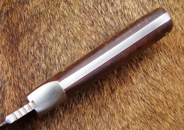

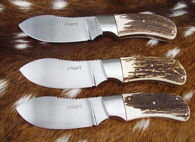

Hello gentleman, show them some pictures of six skinners with same shape but with some distinctive details. This is a type of knife based on the request of a friend hunting guide who was looking for something more personalized that factory skinners which turned this design. The stainless steel used is 4mm Böhler of N678, also bolsters are stainless steel as they both are hand satin finish and have slots in the spine as the curve of the index to improve the grip when the knife greased in skinning, handles are red deer, a type of ebony provided by the client and the remaining imbuia root of Brazil all have red melamine spacers, alpaca pins and finally the sheaths are leather tanned with tannin, oiled and sewn by hand.
Hope you enjoy the photos. Thanks for looking.

The "chainlink" stitching on the sheaths is really interesting. I must try that sometime.
