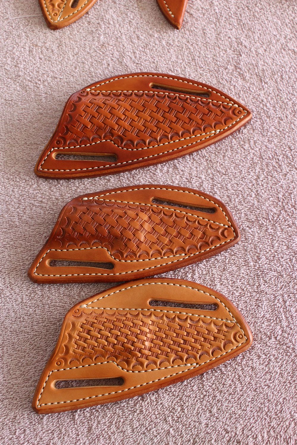

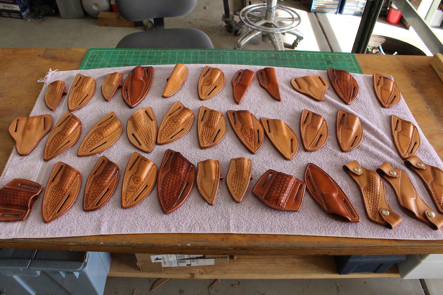

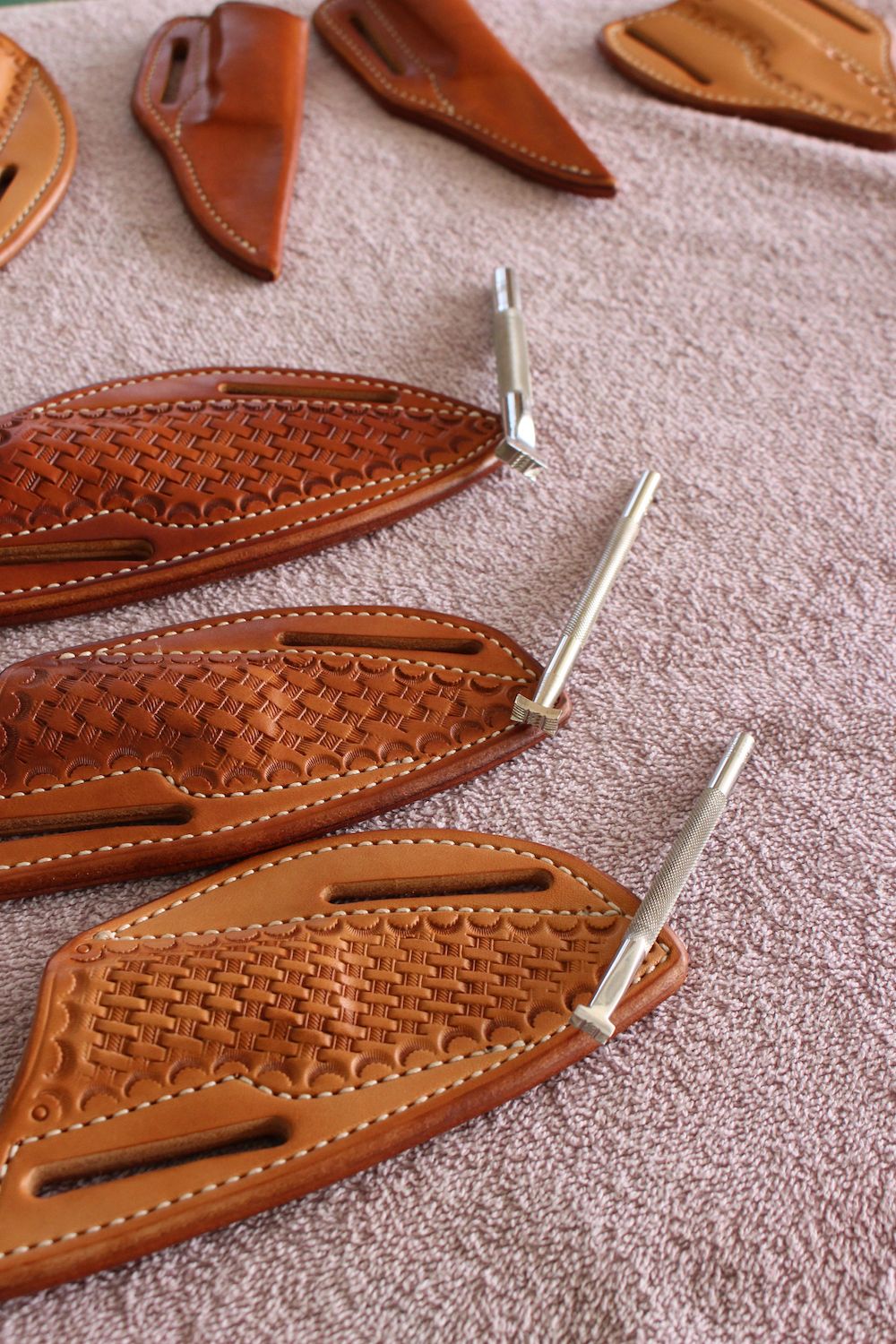

Sheaths I finished up last night. They and their knives shipped this morning. This is the second half of the batch I was working on the first half had already shipped on Monday. I tend to use three basket stamps over and over. These three:
To my eye a small one like the bottom works best on small areas. If ya do to big an area with a small one it starts looking busy to my eye. Conversely the two larger ones don't look right in a smaller area. The top and bottom ones are Horseshoe Brand stamps and don't have numbers. The middle one is from Siegel Leather (went out of business in 2008) and is numbered X513. This hourglass basket stamp is the one I use the most. If given the choice (sometimes the customer is specific) I choose it over the other two all the time. For me its easier to hide any little mistakes. I dislike any of the angled basket stamps. Just don't look right to me.
