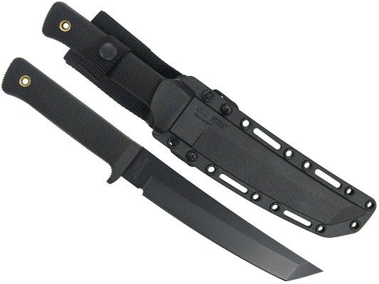

I have a basic understanding of knife steel, roughly as much as it pertains to my use choices. I believe that SK-5 is equivalent to 1080 carbon steel, or something very similar. My understanding is that this is a pretty tough steel with a reasonable heat treat. So my question is...... were do my old AUS8A Recon Tantos's and SRK's stand in toughness compared to the new SK-5 equivalents ? I love to beat knives through wood for a fire now and then. So toughness has always been a primary factor for me. For shear beating the hell through wood repetitively, do these knife steels differ in ability to withstand this....what some consider abuse ? If I bust one I'm not crying to C.S. about it. I busted the thing, that's on me. Besides, they don't cost much and I have a bunch of them anyway. I was just wondering if SK-5 is a tougher steel than the AUS8A for rough wood processing applications ?
As a very general statement, carbon steels like sk5 tend to be tougher than stainless steels like aus-8a. sk5 is reported to be a Japanese equivalent to 1080 steel, as you mentioned.

Another general statement, corrosion resistance, toughness, and edge retention usually gets balanced out. For one to increase another must decrease. This is not always the case, especially as heat treats can greatly affect these for a given steel and then there are grades of steel but as a very topical assessment of steels, this is a trend that can be observed. Steels that are both tough and have good edge retention usually rust pretty easily (tool steels). Very high toughness knives usually tend to have lower edge retention and corrosion resistance. Very high corrosion resistance tend to have reduced toughness and edge retention. There are exceptions to all of those statements, especially as you move into the higher grades of steel with more alloying (super steels).
Thank you gentlemen. This is all pretty much what I expected, and now confirmed. I will be replacing multiple Moras in bags with SK-5 Recon Tanto's and SRK's.

Yes, but the SK5 Recon Tantos have a hollow grind while many of the previous models have saber grinds. The hollow grind is much better for edge holding but not as great for pounding as the saber grinds. I'm wondering how the Carbon V blades fit in to this conversation? Is it closer to the SK5 or the stainless blades? Or to the 3V?

Carbon V isn't really a standard steel and is a bit of a Cold Steel thing. From what I was able to find a while back it was used so they could jump around on the steel types to get better prices without changing the specs. I think it was all aimed around a 1075 or 1080 type level so they would use 1075, SK5, 1070, 1080 etc. interchangeably based on price. I haven't seem a firm answer but others could have. I basically just put it in the "decent but not great generic carbon steel" category in my internal rating system.
I wouldn't agree that a hollow grind holds an edge better. They are thinner behind the edge making them more slicey and probably still slice further down the road into dullness but I don't think they hold an edge better overall. They certainly don't accept the pounding as well as a saber grind, as you stated.

This is false. Carbon V is Coldsteel's trademark for 1095CV, 0170-6 which was used by many knife manufacturers and is still used by KaBar (Becker Knives for example).
If CarbonV was Cold Steel's name for "whatever" steel, then 3V, SK5, AUS-8 would all be CarbonV.
I'm a huge fan of CarbonV (1095CV, 0170-6) but it is a little long in the tooth. I can't speak to how it compares to SK5 but I think SK5 might be virtually equivalent.
